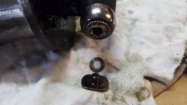

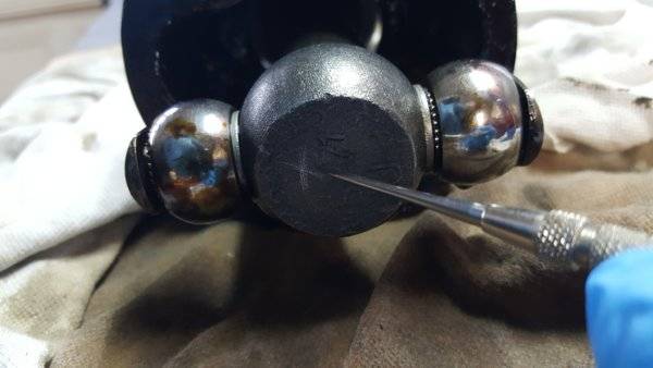

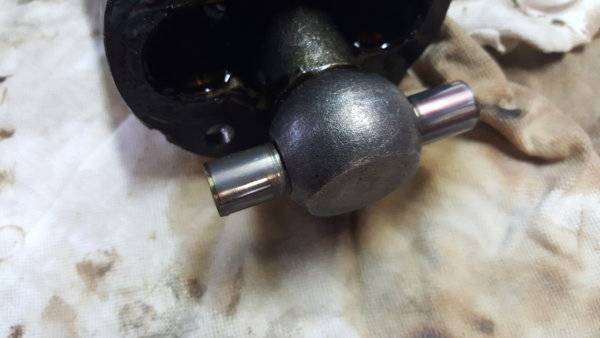

What's the history on the trunnion joint. Has it been rebuilt recently? I know it was on a balance machine but I was just wondering how it might have been included in the balancing procedure.
I know if the pin is off center just a little that it will throw it out of balance. If one of the shims under the bearings were left out, if the bearings or pin is worn out, if aftermarket boot clamps are used and they aren't staggered, if there is a aftermarket boot being used and it's flopping around, if the flange isn't seated properly into the tailshaft flange when tightened.(That's a pretty snug fit) All of these things can cause the trunnion type joint to throw the balance off.

First can you buy a rebuild kit for the trunnion joint ? When the shaft was in the car I checked & rechecked every bolt & nut. The rear u joint is new & tight. My dad bought a new boot from Kramer from PA. The weights they put on it to balance it are all in the back of the shaft. 2 washers about the size of quarters. I put the new boot on before I got it balanced.
There are some rebuild kits out there. Mainly on ebay. If it's in good shape I wouldn't rebuild it. The cross pin would need to be pressed out if it's worn and the new one has to be pressed back in perfectly centered. Mine was original and showed no wear at all, so I just regreased and replaced the boot. Also they don't recommend a lot of grease in one. Only like 4 ounces. Directions state about a 1/2" on the cover plate, take half of that behind the cross pin and the rest in front of it before attaching the cover plate. (No grease inside the boot)

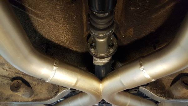

Is the location of the cross pin centered in the travel of the driveshaft when installed. Not jammed foward as to cause binding? Same thing as if you had a newer style slip joint, not wanting it to bottom out in the tailshaft.
This does not have the ujoint angles cancelling each other so the rear needs about a 2 deg drop to cover windup

Had a little time this morning. The drive shaft is 54 1/4 With rear end on jack stands (loaded) the measurement is 55 3/16 With the rear of the car on jack stands / on the frame rear end (unloaded) the measurement is 54 7/8 With the trunnion type drive shaft I don't know any measurements. Is my drive shaft to short to long.
If I had mine up on stands I'd get you some measurements. Maybe if you took the u joint off at the rear and push the shaft toward the front and see how much travel you have. Do this with the weight of the car on the rear axle housing.
Can you turn a rear wheel, with the trans in neutral and see or feel any binding as the joints rotate? Otherwise get a guage to check your angles.
the car it came from would have had more angle because it had a front ujoint
I would think that the trunnion joint acts the same as a regular u joint. Their range of motion should be the same. They could be more sensitive to angle changes? Jmo
