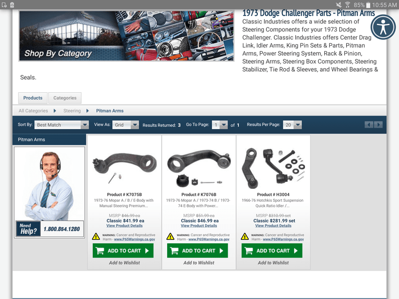

Ya I'm thinking about it, just dont want to tear everything apart I've already done unless I have to. That's why I'm curious about the lg sector from a 73 & up will work with my center link ( 67 Coronet).
I believe a 73 and up A, and E body P.S. arm will work. I have the small sector version of that arm on my 67. Years ago when I bought the arm, the local parts store did not have a listing for my application, so I ordered the one above, and it worked fine. It looked a bit different, but everything ended up in the right place. I think I am remembering it correctly.
Are you sure? Below from Summit;
"Thank you for the inquiry. The K7076 has a tapered spline hole with 32 serrations and 4 flat block teeth. The small end of the tapered spline measures 1.193 and the large end measures 1.224 inches to the valleys of the splines."

You may be right, MOOG has it listed at 1.1 and their sight shows no parts available for 67-70 coronet...even though we all know they exist... I think it's the K7074.
