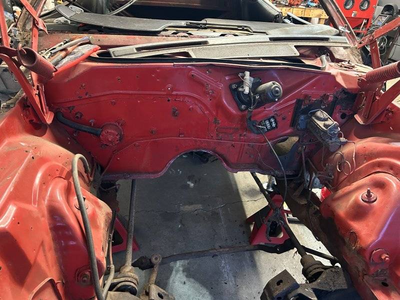

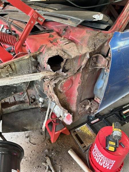

If anyone has any pointers on a good plan of attack on the repair of my cowel/firewall and firewall to hinge panel, it would be greatly appreciated.
1972 road runner
First of all, strip it down to bare metal. We've used the small handheld sandblaster. It works in little areas and doesn't make that big of a mess. This way you can see exactly what you're in for.

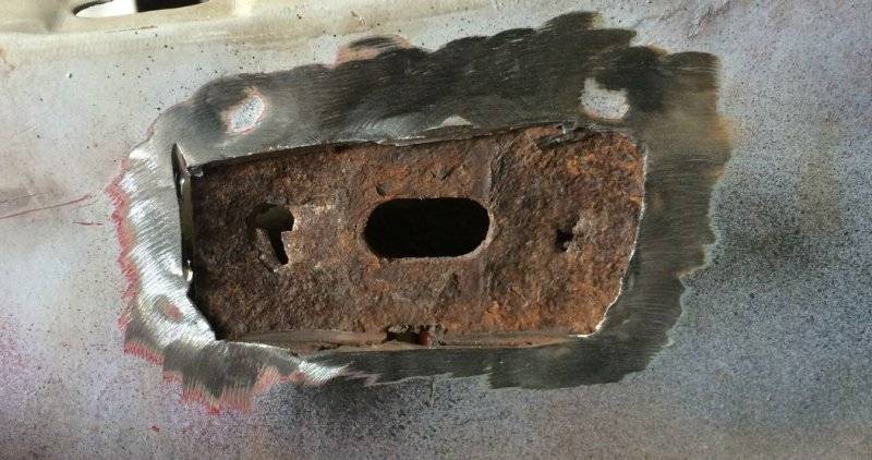

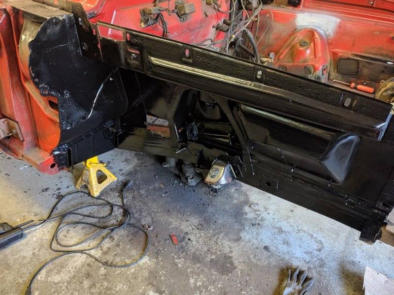

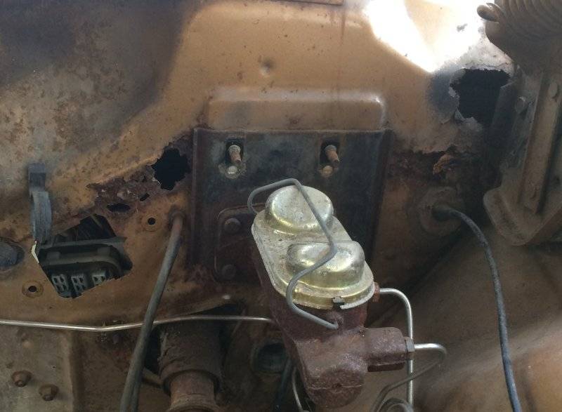

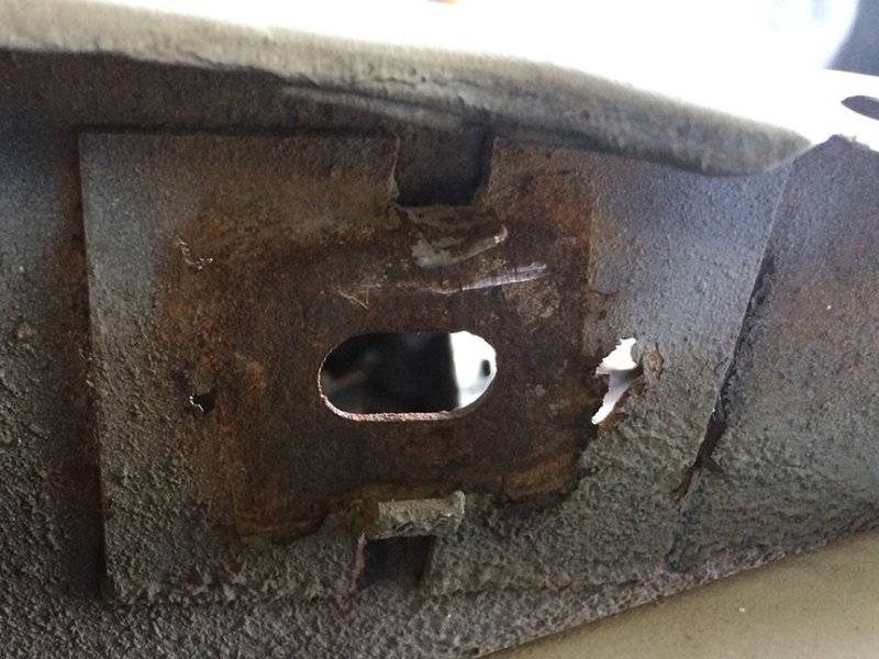

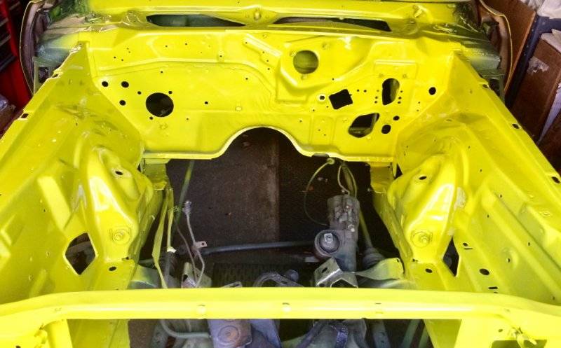

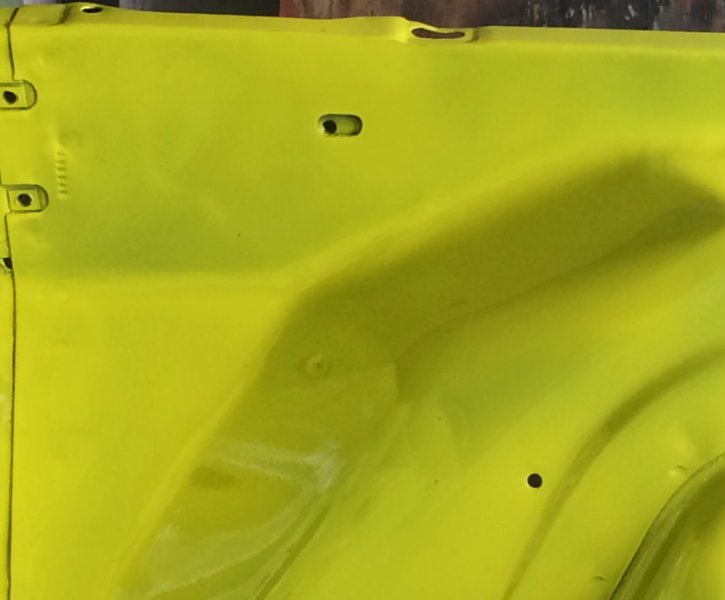

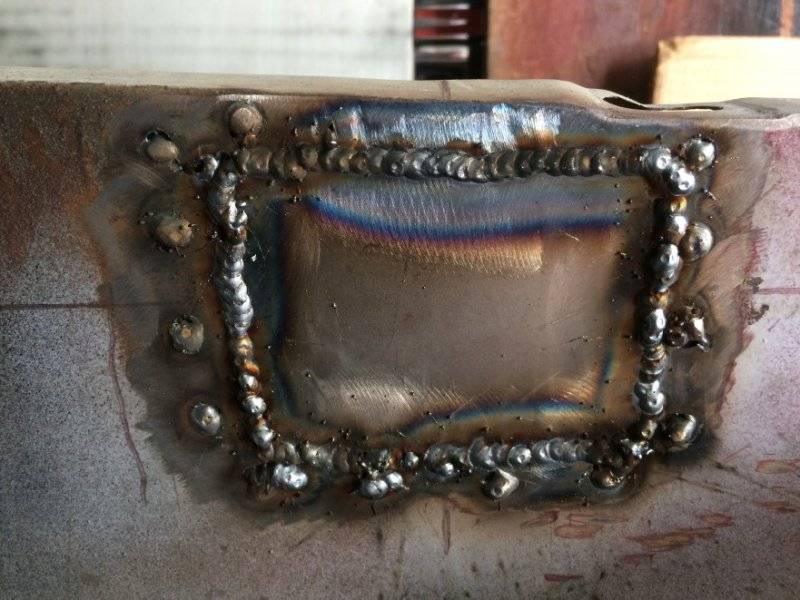

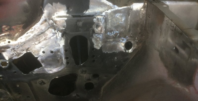

I had to do the same to my passenger side.. it just takes time and some patience... Main thing i learned is.. if you think you cut out enough to get the rust out, cut out another inch.. i tried to save as much original metal as i could and it just made the job way harder (welding new metal to rust isn't fun)
Get some 18ga steel and a hammer and have fun... also.. using .023 wire in your welder instead of .030 makes it a little nicer to work with but you don't have to..
P.S. my car isn't a show car, i just wanted it to be solid and not have holes

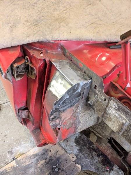

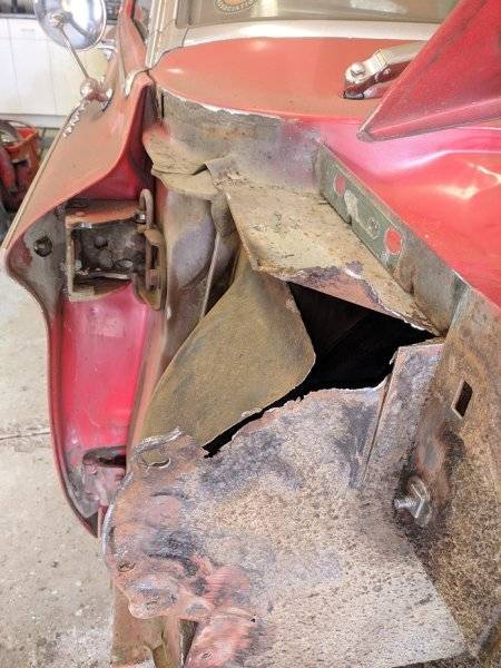

My experience is that once you cut the top off you'll find a lot more work needed on the bottom panel of the cowl and around the plenum. Be prepared to make a large patch panel because you will need room for access. While this area is a total pain in a$$ to repair, but at least nobody can see it if not perfect.
Yu Tube vids help me a lot. When I can see where the original spot welds were helps me in cutting if Im shooting to replace a complete repop part. That, and have the replacement panel in hand BEFORE cutting. As someone here has said, where there's rust, there's more.
