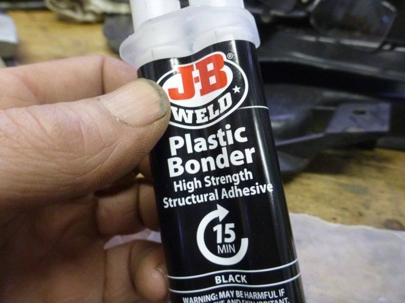

Regular JB did a good job on the mounting lugs that were broken off on my grill, but a couple of them slipped even after I had them carefully positioned and they had tacked. They only moved about 1/16". Just enough to piss me off but still be functional. Fortunately can't see them. Color is real close to factory unpainted areas, too.
