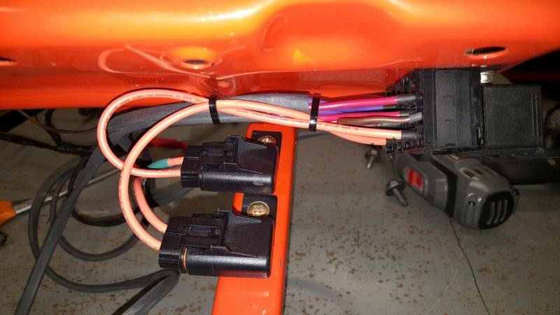

My '70 Charger posed some troubles when I swapped in the CrackedBack relays and harness.
It had nothing to do with the parts. The '70 models headlight door relay (Maybe others too) seemed to leak a small amount of voltage that didn't play well with the new harness. I had to switch to a Bosch relay for the headlight doors. Once I did that, everything worked fine.

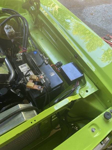

My first choice was mounting under the battery tray as well, but I have a vacume booster tank under there. With plenty of room on the fender, I bought a weather proof box and mounted relays in that.
I have a vacuum can as well, no issues with mine. I didn't put mine in a box. I figure if water gets all up in there, then there's issues
