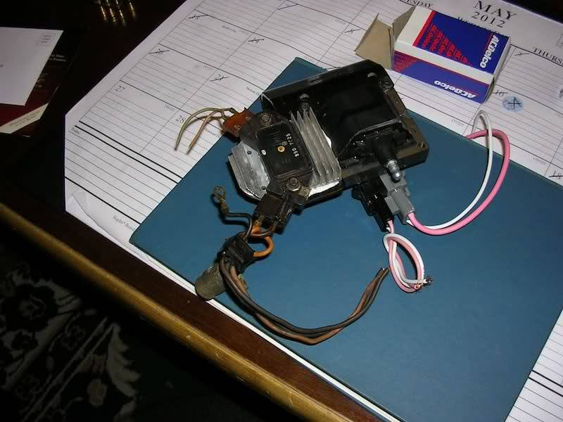

I will say this, if I were to start over again (and may have to) I would go with the GM conversion. However, if you just want basically a drop in to your existing distributor, Pertronix is easy and so far reliable for me anyway. If you would like to see how I wired it all up, I will take some pictures and post them. You will be by passing the ballast resister for either set up as you will use battery voltage.
Not trying to hijack this post. Dan, can you help me with the wiring on this? I know the green and tan wires on the left side of the HEI unit go to the distributor. There are three wires on the other side two are connected to the pink and white coming from the black connector (the third is black and is a ground wire). B which is tan should get 12 volts from the primary side (pink wire with black connector) of the coil and the white wire is connected to the "C" wire on the module which brown. The heavy pink from the gray connector gets battery power that I will have coming off a relay. The white one is for a tach. Have I got that right?
I think you've got that right, but I am on day 2 of trying to stop drinking coffee, so take that for what it's worth!
