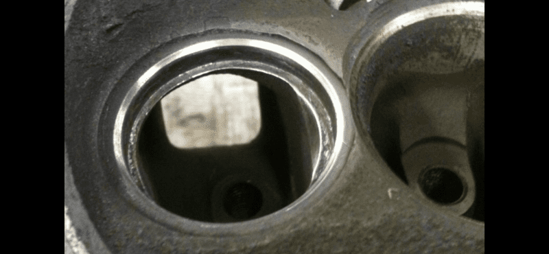

In the grand scheme of things, installing hardened ex seats is a pretty small add-on to the price of rebuilding an engine.
I’ve had heads come in where the ex seats had about a 1/4” of recession.
WaaaaaY worse than the OP has here.

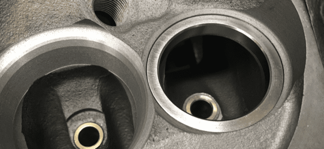

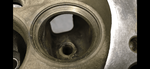

Of course, not all machine shops provide the same level of work, and I’ve seen plenty of ex seat installations that weren’t great.
Here’s two lovely “flow enhancing” examples-
I particularly like the peening of the lip around the seat insert on the second pic.
Oh, and both of these examples(two different pair) happen to be T/A heads.
As ugly as they were, they weren’t loose or leaking…… and they were a larger OD than are recommended ……. And they were T/A heads………so I left them in place and just did my best to blend away the step that was left by using inserts with the ID way larger than the original bowl diameter.
That seat has been cut way too many times!

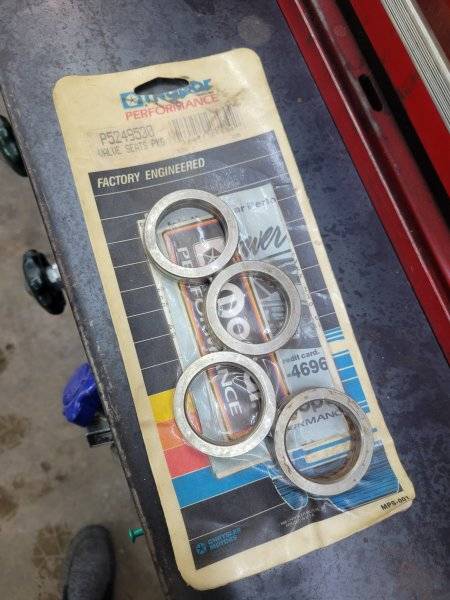

For what it's worth, I've seen a few heads with seats so wore out that the springs could rotate with ease. Hardened seats weren't too expensive to put in. Sometimes it's a matter of whether the head will take it or not.
I had a set of 340X heads built with intentions of installing hardened seats, but there wasn't enough material left in the head to hold them.

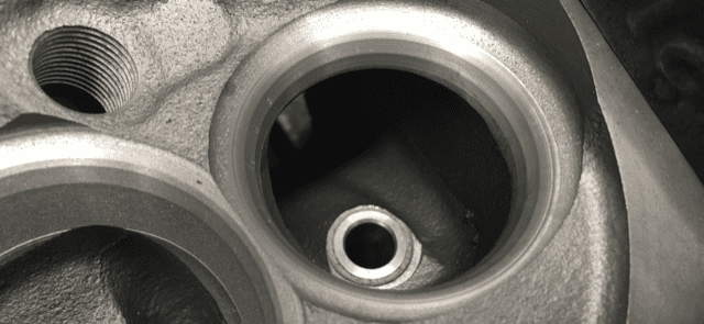

I like to use seats with the ID sized close to the bowl diameter of the head they’re going in……

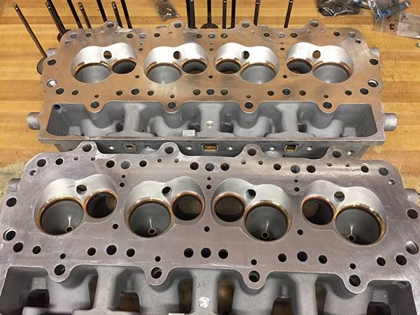

What type of material are the seats made of that look like bronze color? I've seen pictures of them on
Mopar Nascar heads and always wondered?

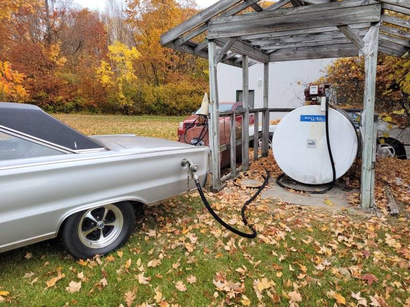

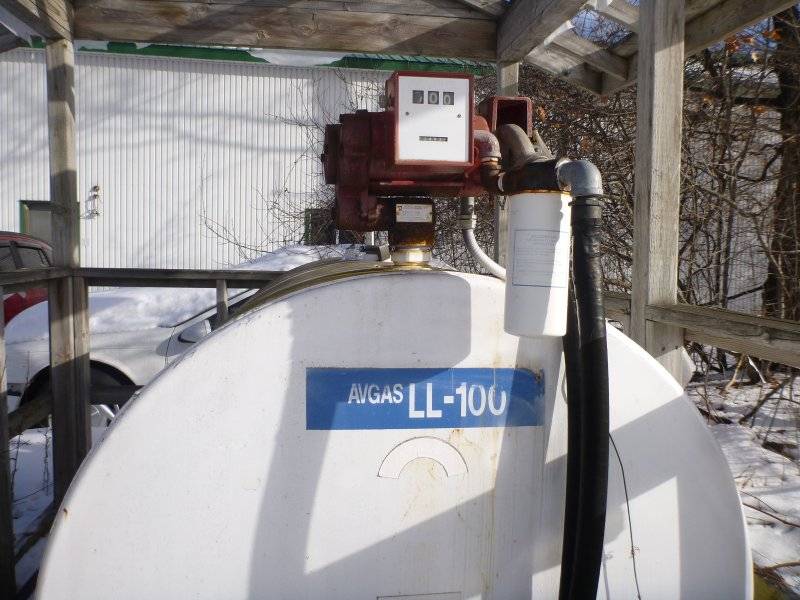

I wish I could get leaded around here!
Ahhhhhhhh, Beryllium! Nasty stuff. O.K., Thanks. No Titanium valves for me!
