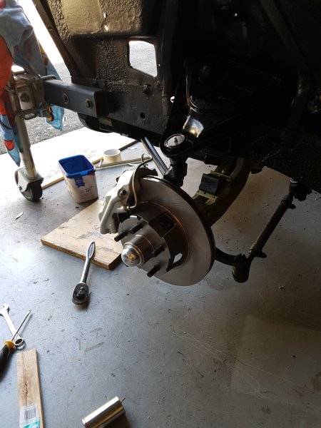

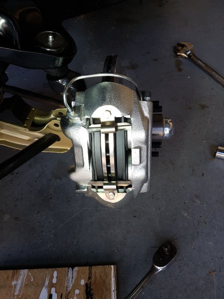

My car came with 10" drums all around. I swapped to A-body front discs within the first couple months of owning the car, I tossed the front drum assemblies because in 2000, nobody that I knew of was basing front disc brakes on the old drum knuckles. Maybe Wilwood was and I didn't know?
I went with a power brake kit from PST, made by Leed Brakes. 10" discs I think, nothing fancy, so I could use the 14" Magnum 500's I had.
Works great, strong & even braking, definitely better than the drums I had on it. Kit came with a proportioning valve but I didn't use it, just a new distribution block.
Very easy install, good instructions, and very good customer service. The first master cylinder had a rough top casting and leaked around the lid - Leed Brakes sent me a new master cylinder free of charge including postage, all the way to Australia.
Also before I had even installed them, I received a big padded envelope with 2 spacers in there. It seems they had sent out some kits with the wrong size spacers and then rectified the issue by tracking their sales and sending everyone the correct ones. I hadn't contacted them about this issue, I hadn't even opened the box at this stage as I was busy with home renovations.
