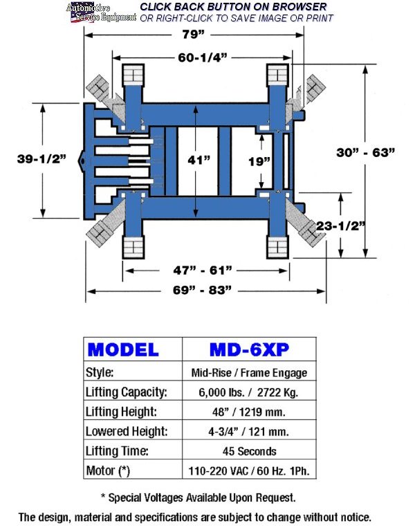

Bendpak site... http://www.bendpak.com/car-lifts/specialty-lifts/md-6xp.aspx

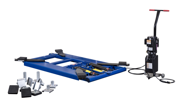

I think the Maxjax or a simiiar model would give you more easy access to the underside of a vehicle. I think Mr. Cranium has something like that in his garage - maybe he could enlighten us as to how well they work.
Thanks for all the responses, gents. there are a few reasons that i am considering getting the scissor lift..
the maxjax is a bit more pricey than the scissor lift (like $300 more)
1) room! a post in the middle of my garage would take up a lot of space, and i might not be able to get another car in with the post there.
2)im a bit weary of a two post lift that is anchored into the concrete with just 6 of those wedge anchors...not too sure if my old-*** concrete could take the stress of the lift going up and down. the concrete is in relatively good shape, but it is 30+ years old. i guess i could use a dead-man (maybe a trans jack or something) on the rear end to stabilize it, but IDK...
3)bend-pak is a good brand whereas i really haven't seen much from dannmar
I do realize that i wont be able to do any trans work or exhaust work, and that is one of the reasons why I haven't pulled the trigger on the scissor lift.
the lift would mainly be used for front end work--suspension and motor work and also for changing tires and brake maintenance etc.

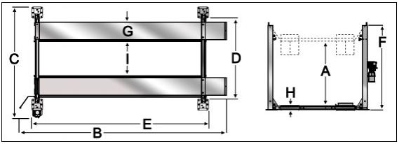

How about a 4 post lift Pro Park Plus 8 PP8P $2395, you have a great place to work on the car, comes with other useable optional stuff too & storage for another car underneath if necessary... try @ www.shopequipmentlift.com/for-post-lifts/pp8p/ that is the one I was going to buy... but I haven't yet
of the 2 you have shown I say the top one Max Jack it would be much more user friendly, that the Bend Pack also only lifts 48" of lift

Buds: i would love to have a 4-post lift, but i definitely dont have enough room for that.

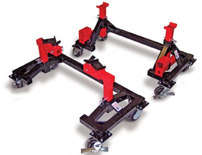

Yeah with a 8' low ceiling, a limited lift height, won't hurt you... the lack of access under the car will thou... maybe "something like" the Back Yard Buddy Easy Access Dolly's possibly will help get the car up & safe & are far cheaper than, you will still need a good high lift floor jack thou, to get it up on-top of the dolly's... I've been considering them myself too... or even make my own
