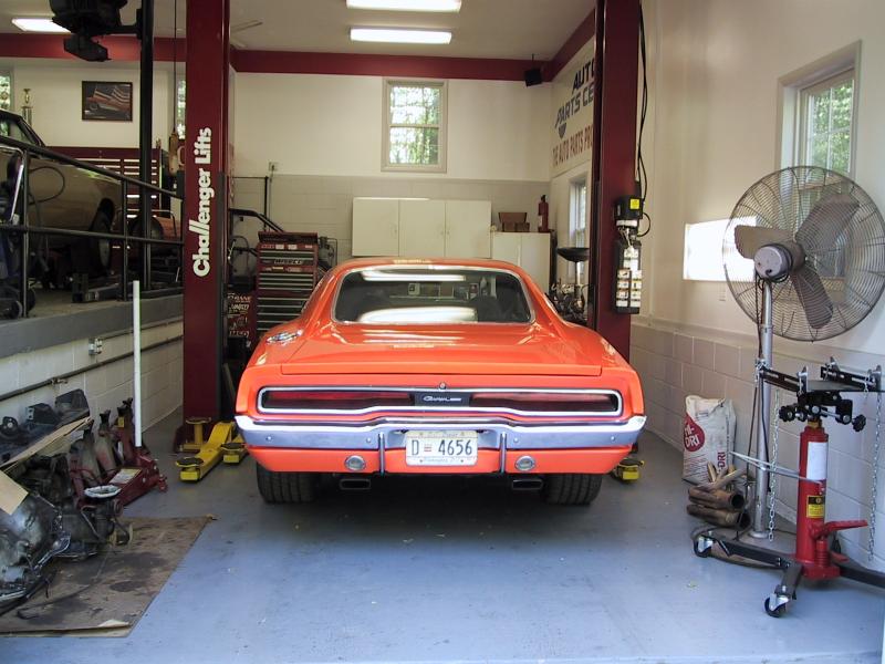

Here's the one I use. Challenger makes a good lift.

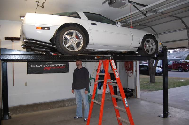

My lift in my garage.
