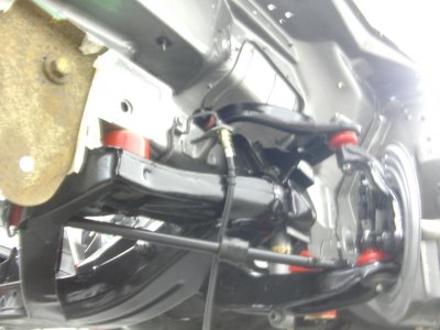

I like mine so far and they were cheaper than rubber for me here in Canada....One thing...DON'T trust anyone when it comes to the strut rod bushings they are marked 73-74 B-body but they are way to small and only fit the older style K member.I have 3 sets here from different places that all say the are right but guess what there not....Let me know if you come across some that fit.BTW..I don't have any problems with rubber I just liked the look of the red poly and the price :)
The theory behind poly-graphite, is that it is self lubricating, thus helping with wear, and eliminating squeaks associated with standard polyurethane.
Poluurethane doesn't deteriorate like rubber, and provides a firmer ride, at least those were the selling points 20 years ago.
Gentleman.......you are awesome thanks for the input. YY1---great pics thanks for your time. You are correct that red looks........badazzzzz. I like the thought of firming up the ride and dont mind lubing later. Like my friend says.......if it squeaks later.......lube it! Ill look into the poly or poly graphite. The whole front end is swaying back and forth and when I put the R side up on a stand you can wiggle the whole wheel. Im going to replace all the metal/rubber in there with a front end kit.........probably from Ebay or PST.....they range from 250-500. In the process of changing out my front rotors, bearings, calipers, shoes and lines..............j
