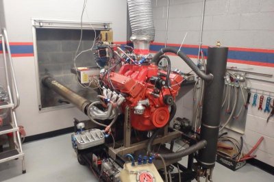

P2081509.jpgRecipe is pretty simple...
318, .040" over + 4' stroke = 392 CI.
9.5:1 custom pistons, .470 Racer Brown cam, 4" stroke Eagle crank, Eagle I beam rods, new Chrysler Power intake, 1.95/1.625 valves, 750 CFM Quick Fuel carb
Here's a photo of it on the Dyno...

With the experience I had, I would HIGHLY recommend that you dyno the motor for break-in and tuning PRIOR to putting it in the car. The part of the story I DIDN'T tell was...I had a rocker back off and it bent the #6 intake valve. We pulled the head and discovered that the pistons had the fly cuts cut in the wrong location. Before anyone asks...no, I stupidly didn't check piston to valve clearance, but if the pistons were done correctly, I wouldn't have had to. Long story short the other 7 intake valves were bent slightly too. The engine had to be completely torn down to re-fly cut the pistons, cut a new valve, and straighten the other 7. The dyno shop did it all tear down, repairs, and re-assembly right there in 1 week. Jim Bowen Racing Engines (the dyno shop) was an absolute savior in this situation! I would recommend him to anyone and would him in a heartbeat!!!

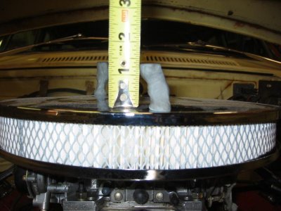

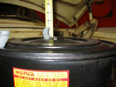

I think these pictures say it all. (I have to give Ricky Hall form the 62-65 Mopar List credit for this photo)
View attachment 247057View attachment 247058View attachment 247059
