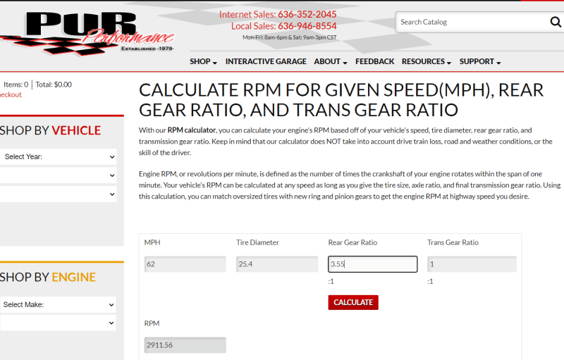

Thanks 66 Sat, that's what I thought too...Error in your calcs Don, the tire is 24.5" (actually 24.7" according to internet).
You've put 25.4" in the calculator.
Ok ran it again but it still doesn't match what he describes:Error in your calcs Don, the tire is 24.5" (actually 24.7" according to internet).
