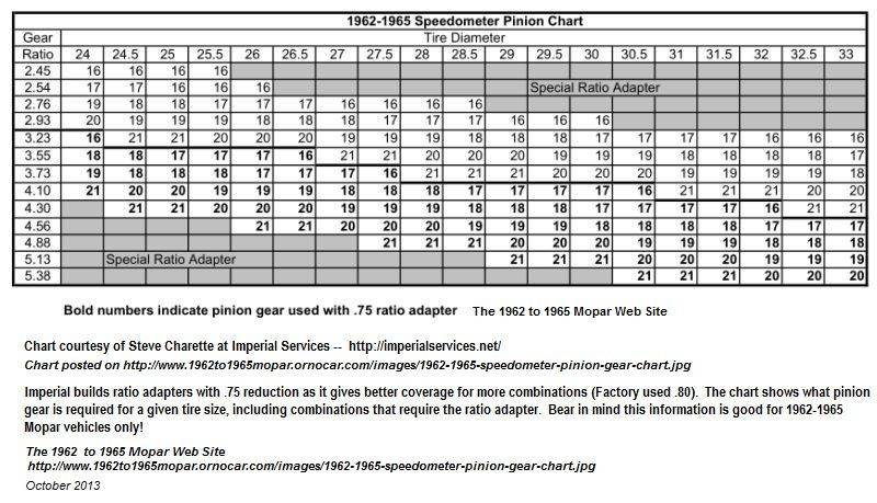

One thing you might check, is the right speedometer gear being used for the 3:23 rear and tire diameter. That could throw your calculations off.
Yes makes sense, I'm currently in the process of receiving some 28ish inch diameter tires to replace the original style I'm wanting to maintain. What concerns me even more at this point is that my current 24.5inch diameter (approx) tires are actually giving me a reading of more miles than I am actually covering in reality, I e. My speedo is actually reading approx 70mph when I'm actually travelling at 62mph due to this factor!!
