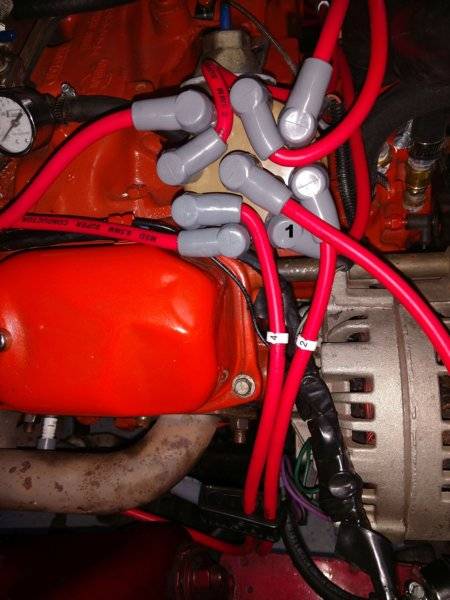

So, time to install a decent set of spark plug wires on the ol' 440. The kind you have to custom cut and so forth.
No big deal, done it a hundred times, right?
Remember, this is me we're talking about...
Study the picture below of the finished product. Who can spot the teeny tiny mistake I made first?
I could be wrong, but I don't think 1 & 2 are supposed to be side be side
Firing order is screwed!
Buzzer sounds...
Firing order of a 440: 1-8-4-3-6-5-7-2
#2 & #1 are indeed next to each other in the cap.
You are correct as far as you go.
Now, take that out to the full answer!
Wired in the wrong direction. That is something I would do. Wonder what would happen if you fired it.
#8 and #4 are supposed to be next to each other.
What about the coil wire ?
Counterclockwise, 1-8-4-3-6-5-7-2
Wired wrong direction? Should be Counterclockwise.
Buzzer sounds...
I should of been more specific
I know, you forgot to scuff and paint your headers with high temp b-b-q grill paint before the new plug wires !!!
k , what do I win!
Judges?
(Judges huddle up and confer, then hand Ed a small piece of paper)
The judges' final decision is that THIS IS THE FIRST ACCEPTABLE ANSWER.
Congrats, HT413!
The answer we were looking for is "That dummy Ed wired the thing up for CLOCKWISE rotation, not the 440's correct COUNTER-CLOCKWISE rotation."
Perfectly, I might add. :)
The truly sad part is the whole time I was out in the shop, sweating my *** off (it's friggin HOT these days) I had in the back of my mind "counter-clockwise, Ed".
I get it done finally and go in the house, directly to the shower....
and then it hit me:
I did what?
The only saving grace was that I didn't attempt to fire the GTX up whilst wired dumbassedly - and that I figured it out before attempting same.
Bad part was/is - the wires were cut to fit nicely in the WRONG rotation.
Sigh.

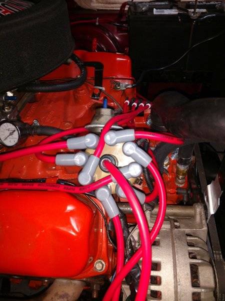

EPILOGUE:
Went out this evening and corrected the sitee-ashun:
