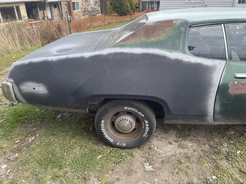

I'll add this while I'm at it. Personally I feel like this is a mistake for AMD because of the growing popularity of the 73' & 74' Satellites & Roadrunners. Now I seen a picture of 1 that a gent put a 72 half/full quarter on and the body line discrepancy. I couldn't live with that. The only way to fix is to cut it out and rework it. The area referencing is in front of the rear tire. Can't just grab a door and put it on, the body's curves don't line up, the curve of the front portion of the doesn't match the rear most part of the fenders. So,,,,,. The long way to rectify this is use the quarter, but cut out and rework the discrepancy.
