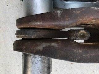

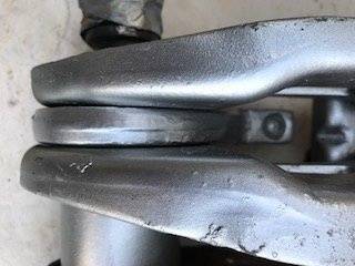

Hey Guys,

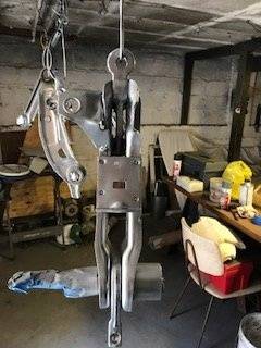

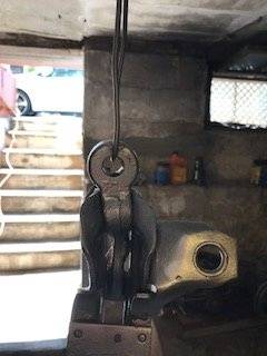

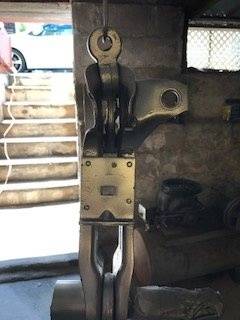

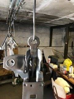

After I got through painting my lower control arms, I noticed a slight bend on the drivers side one where the spindle attaches. The first two pictures show the bend, and the last two show the similar area on the passenger side's lower control arm. Can someone tell me if this bend is supposed to be there, or if there is an issue here.
Thank you!

Sorry to say but time to spend some money. Had to change both my lowers many yrs ago.
Go with the qa1 tubular lowers if you're open to aftermarket, very nice piece

Does anyone think it can be straightened out at all?
Trash it.
Never ever straighten or weld suspension or steering components.
Your life is worth more than any piece of metal on your car.
A bend that bad will not allow you to get even caster numbers for alignment. It is best to replace it. The main part of the control arm is stamped steel. It can be bent back to shape but the part on yours that is bent is drop forged steel. It is difficult to bend back to shape without using a torch. The torch affects the temper from the forging process, making it more likely to bend again.
It could be cold bent in a hydraulic press but I'd wonder if it would weaken it.
OH NO!! I'm in trouble!! :D What about those braces that you can buy (or make your own) to weld onto the lower arms to strengthen them? There's a lot of them on the road.
On a serious note, you would probably do more harm trying to straighten it than it's worth but I've been modifying suspension parts for a lot of years but I wouldn't even bother with that because it's really not worth the effort.
When I say about welding or straightening suspension or steering components....I mean the forged pieces that should never be tampered with. The LCA mods that are available here and widely used are exempt. :D
Thanks for your input Cranky....and forcing me to make the point clear for others. :thumbsup:
When looking for a replacement - be sure it has the sway bar mount already welded on or you will have to buy one of those too and have it mounted. As someone noted above - it would be a good idea to check the spindle to make sure it isn't damaged/bent.
Thanks for all the responses guys. I think you're all right, and I will not attempt to reuse my old LCA.

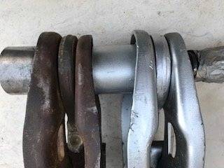

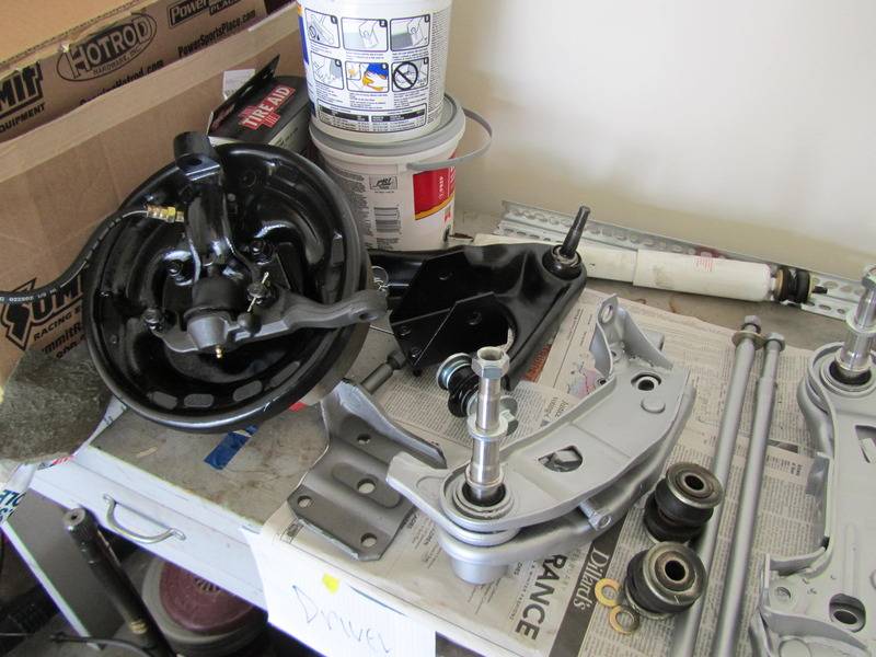

So I was working on the new control arm today, and notice that the adjustment arm has some slop in it. My pics below are trying to slow the gap I am referring too. I was able to tighten it up a bit, but then it started to restrict the movement of the arm itself.
Does anyone see any issue with the current gap (the rusty looking control arm)?
The silver-ish one is my old bent one.
How are you trying to "tighten the gap"? In most cases when there is play in the arm most will clamp the arms to squeeze the arm bacak together and take out the play. Then weld on a stiffening plate to hold the two halves of the arm together. How much play is there?
