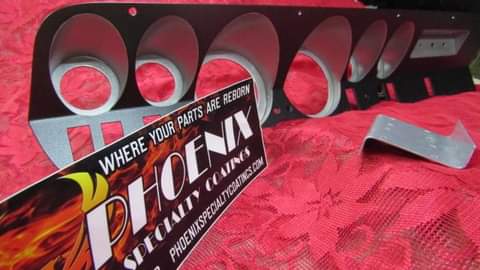

Keep us posted on how it turns out! My last one was a famed Rocky Mountain Dash insert. Turned out great -- a new black leatherette on the face and silver/clear in the gauge pods.
Eight Bucks... I'd want to see some examples of their work before handing them any parts!
Cudachick, those look great! I thought $80 did seem on the cheap side as well and I know they old adage of “you get what you pay for” largely holds true, however, they media blasted and coated my entire car at the start of this endeavor and later the K member, and I thought their work was great. If Tennessee wasn’t so far from Arizona, I would be visiting CudaChick. Perhaps I will visit them again, show them the actual parts and try get a feel for their level of confidence. My list of dash parts to be coated has grown to the the dash frame itself, outside ac vents, center ac vent bezel, switch bezel, ash tray door, glove compartment hinge, and heater/ac control plate.
