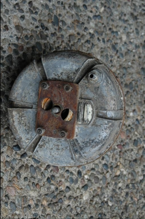

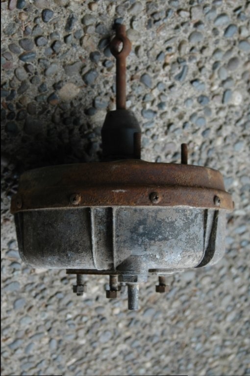

A photo of a 62 / 63 booster. Yes the firewall bracket is different, not pictured.
my 63 is different. Mounting looks same but diaphragm is different
My photo is of a Midland-Ross, which I have seen as common on the 1962 B's. Also offered was a Bendix for the B bodies in 1963, and carried over to 64 +. The parts book doesnt show a Bendix in 62. I would have to investigate, but I think the push rod interchanges to the manual brakes
