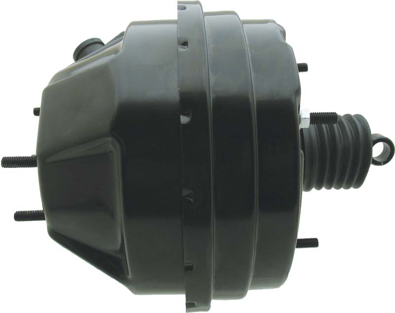

Pirate jack...

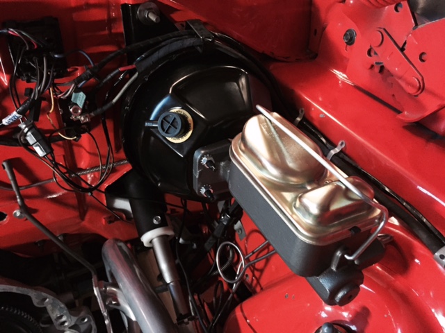

New Booster Installed
Here's a picture of my install from Pirate Jack, I did have to grind the mounting plate and firewall a bit to get the assy. to fit. The diameter on the rear of the power booster assy is a little bigger than stock. Nothing major, one other thing--- make sure you bolt on the linkage before you attach to the firewall, you won't be able to do it from the inside.
