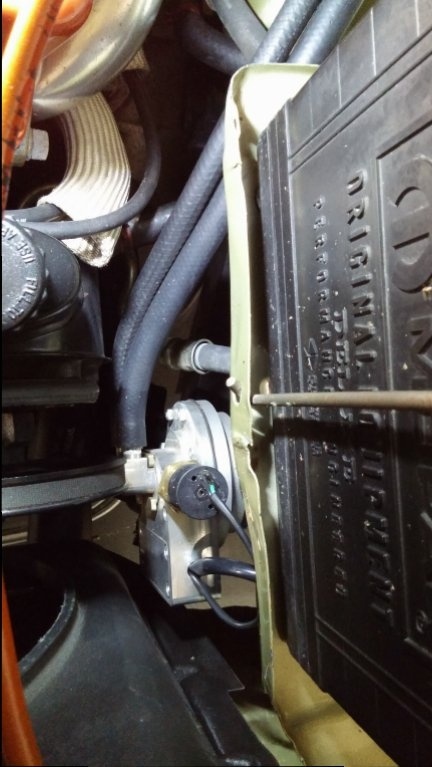

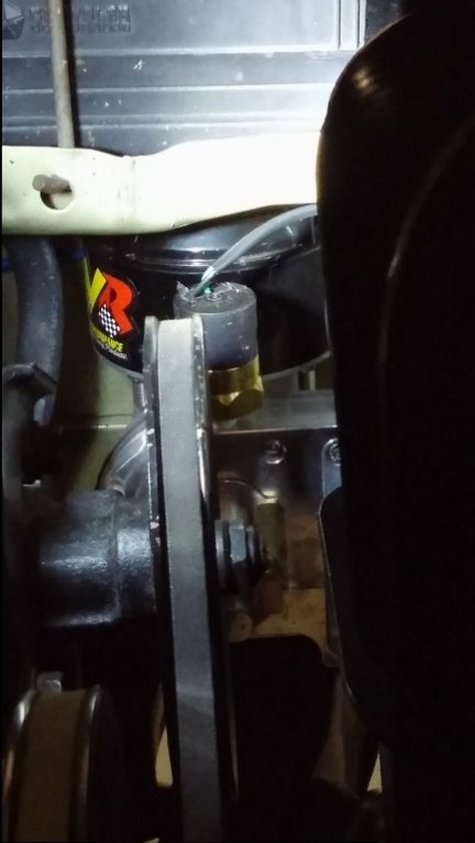

I use a CVR VP555 vacuum pump mounted under the battery tray. You really have to look to know it's there.
