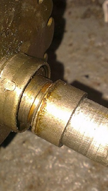

2015-02-02 15.39.36.jpgI've pulled the bearing and casing off and there's a small collar behind the bearing in front of the gear that locks the steering.
I think this collar should be on the other side of the bearing to act as a spacer, to keep the press on horn ring from crushing the ind switch. Can someone confirm this.
I have enclosed a pic of the collar which was covering the front receiver groove for the spring clip. Behind the clip is the rear spring clip and behind that is the gear with a little tin cup on it

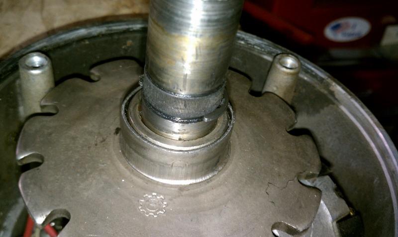

Does this help? This is my column from my 73 RR, only picture I have of this section.
I have sussed how it goes now, you are showing where the bearing goes, on mine someone had fitted the small spacing collar there and the bearing in front of it, instead of spring clip, bearing, front spring clip, the casing and bush spacer to stop the horn ring crushing the ind switch.
