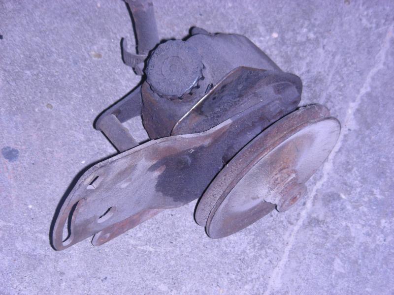

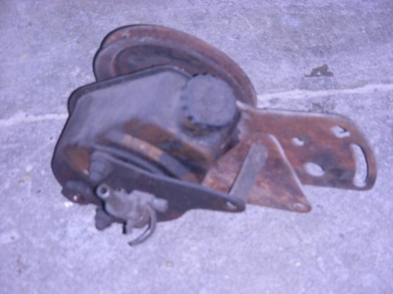

DSCN7735.jpgDSCN7734.jpgI have this power steering pump and it seams like the brackets will line up with the exception that there appears to be one peace missing. I'm building a 1969 Charger with a 451 (400), I know it isn't correct or at least doesn't look like the ones I've seen on them but will it work and does anyone know what's missing.
those are small block brackets. I just went through the whole ordeal trying to make them work. I finally ended up getting BB brackets for my Saginaw pump. save yourself the hassle and just find the right brackets. Mancini has them , or maybe someone here does.
I kinda thought it might be seeing how I don't ever remember owning a BB one and have had a few 318's, but it sure looks like it would fit. Thanks for the info, looks like I'll just find a whole new setup.
I am having fits trying to figger out which brackets on PS pump, Alternator and correct pulleys to get everything to line up Check out 440 source . They have the brackets with pics of them . Seems like reasonable prices for new ones .............................MO
