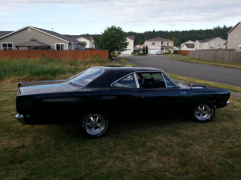

Hello guys I am looking to put power steering on my 68 road runner it is factory manual steering but it has just gotten to the point were I cant maneuver it very well maybe I'm just getting to damned old. What all do I need to do to do that? Can't I just buy a power steering pump and steering box off of eBay and mount it up as long as it is for my year and my motor 383.
Thanks everyone.

Nice Runner, Bitchin stance.
