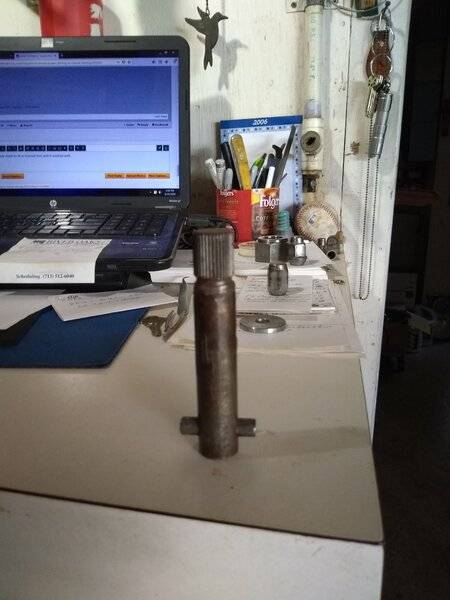

I modified an E body shaft to fit a manual box and it worked well. I just cut a shaft at a wrecking yard (yeah, years ago) from a manual car above the weld. Was surprised they were also splined once the weld was ground off. If you have a manual shaft and don't want to totally dissemble your power steering shaft and have to resources to weld it back together, this might be an option. Don't know why I saved it but this piece is the old PS end.....the manual looks the same but is just longer.
Should mention also that the exterior tubes are different lengths between the 2 as well. That part will work, but a guy can easily tell if you didn't swap it out when making the conversion. If that matters to you...
