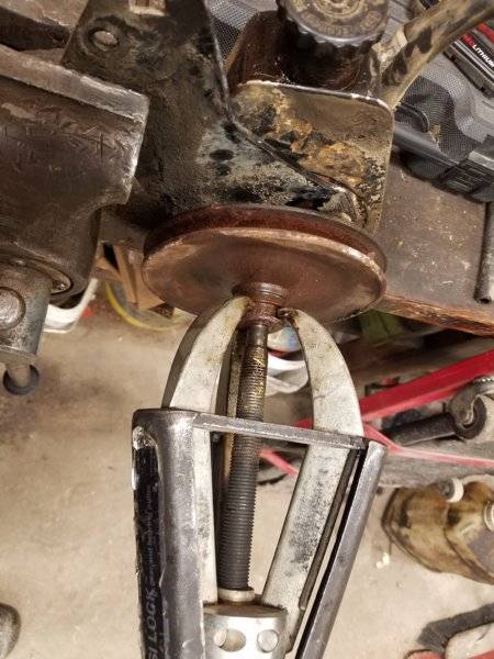

Decided to take the pulley and brackets off to paint them.
Pulley is being stubborn.
If a guy is careful, is it acceptable to use a little heat?
I think the right puller is the 2 piece cup with the steel band that slips over it. I know when my alternator pulley came free it was with a lot of torque and a loud pop!
I know my killers probably a bit bigger than the required puller put it's what I have one hand.
I'll try wacking the bolt head.
Maybe if it sits for a few hours with tension and penetrant?
If I were to use heat it wouldn't be on the shaft
Are you going to reseal it (very easy and kit is inexpensive). If so I would not hesitate to put a little heat on it.

Watch the order the valve and spring come out when you remove the hose nut.... :)
