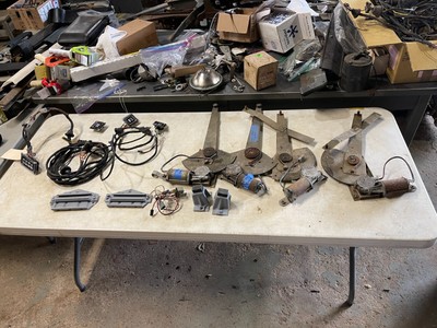

Here's a set on ebay which shows all the necessary parts. There are some special power window parts which are different from manual window cars such as the bottom stop and the bracket that attaches to the glass.

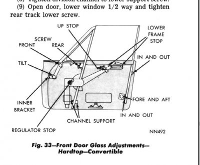

Can you please tell me WHERE these stops are? I suspect one is in the rear track holding the glass. I know the glass has a STOP thats more or less screwed / fastened into the bottom of the glass that could stop UP travel...but I dont see a down stop. AND - the servos on these NU relics are STRONG and want to really PUSH things out of shape.
My B Body is a 68 which is a little different than a 70 but mine is also a vert.. So I got not good pictures but this is a screen shot of the 70 manual...
Thanks for the illustration...but NOT helpful now because Im installing Nu Relic power operators.
