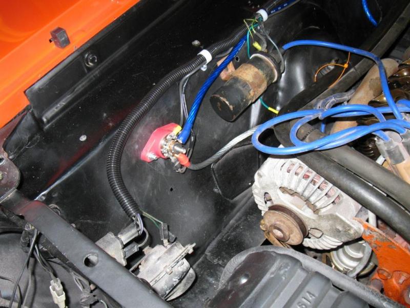

februnner 003.jpgI have run a block mounted in the engine bay to run my accessories.
