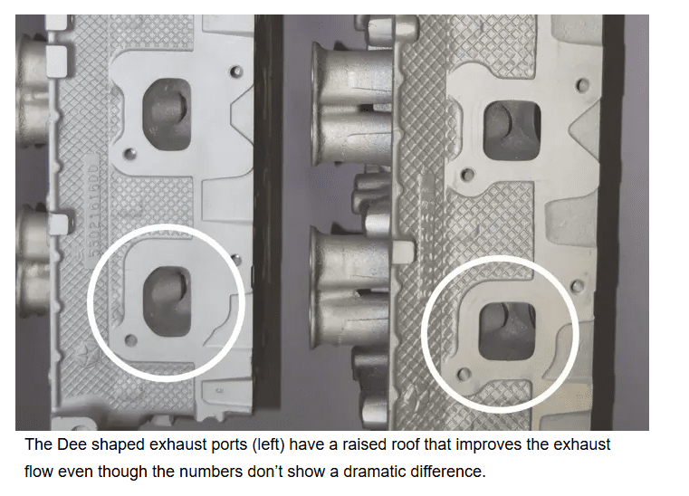

I think TTI or someone used to make Hemi Long Tube Swap headers for the 2003-08 5.7L.... now pretty much all that I find is 09+ Eagle Head 5.7 options.
Hooker does make a Shorty header option that would maybe work? Part # BH2375 Fits 1966-1972 B-Body - Manual Steering ONLY.
I know some people used to say Durango exhaust manifold would fit maybe?
I have an '06 Hemi with 50k miles, Megasquirt & wiring, Mildon Oil pan already put on..... so I'd rather not start over with an 09+ Hemi.
Just curious what others have done?
I guess I could be wrong but I am pretty sure the exhaust ports are the same for the 06 and an Eagle (09+) hemi so the headers should be interchangeable.
I think they will bolt up, but the Exhaust Ports are different.
On Doug's Hemi Swap headers(D4477) I see this review...
I should probably just call TTI and see what they say, if their picture is correct they are large square ports that maybe fit both heads ok.
