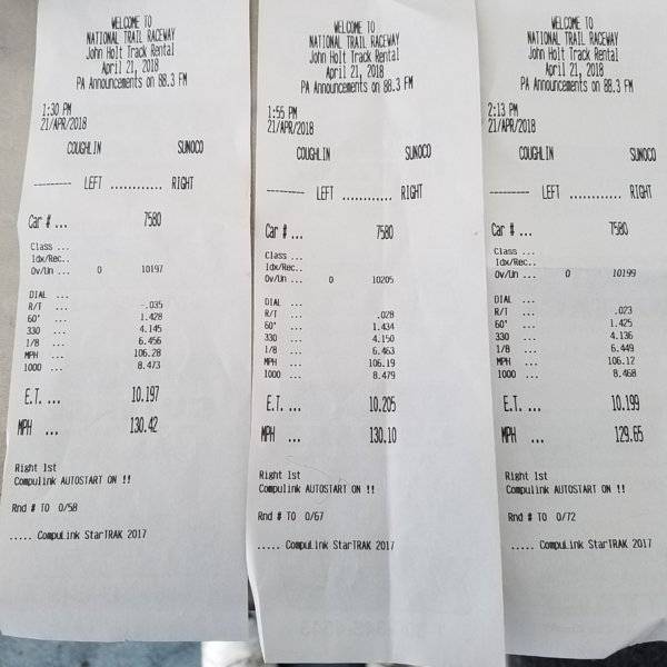

1st time out this year. Freshen up the motor, repaired the transmission after rear end breakage, new ring and pinion . Put these 3 passes together running hoosier 30x9 radials . Driver needs to work on the rt's.
I made 10 passes total, put 4 10.34- 10.35 passes together with 29.5x10.5 bias slicks . The radials are a proven .15 quicker than bias. The radials did add 300rpm at the stripe .

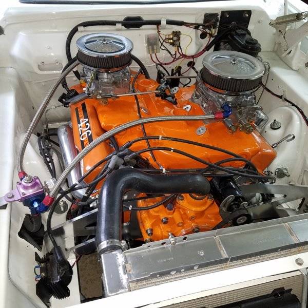

All runs with these tiny air cleaners
Nice runs... that's a lot of passes for a John Holt event
Interesting video , not sure what is good or bad. 10.34@129
Looks good. That can only be bad for the rest of us.

I was waiting for your response..lol
Like I said still need to work on the rt's!!
I hadn't had the radials on the car for 3 years, took a little tuning to get them to work. It's crazy a smaller tire will pick up like that. BUT, when those radials spin its over! no recovery with the hoosiers.
