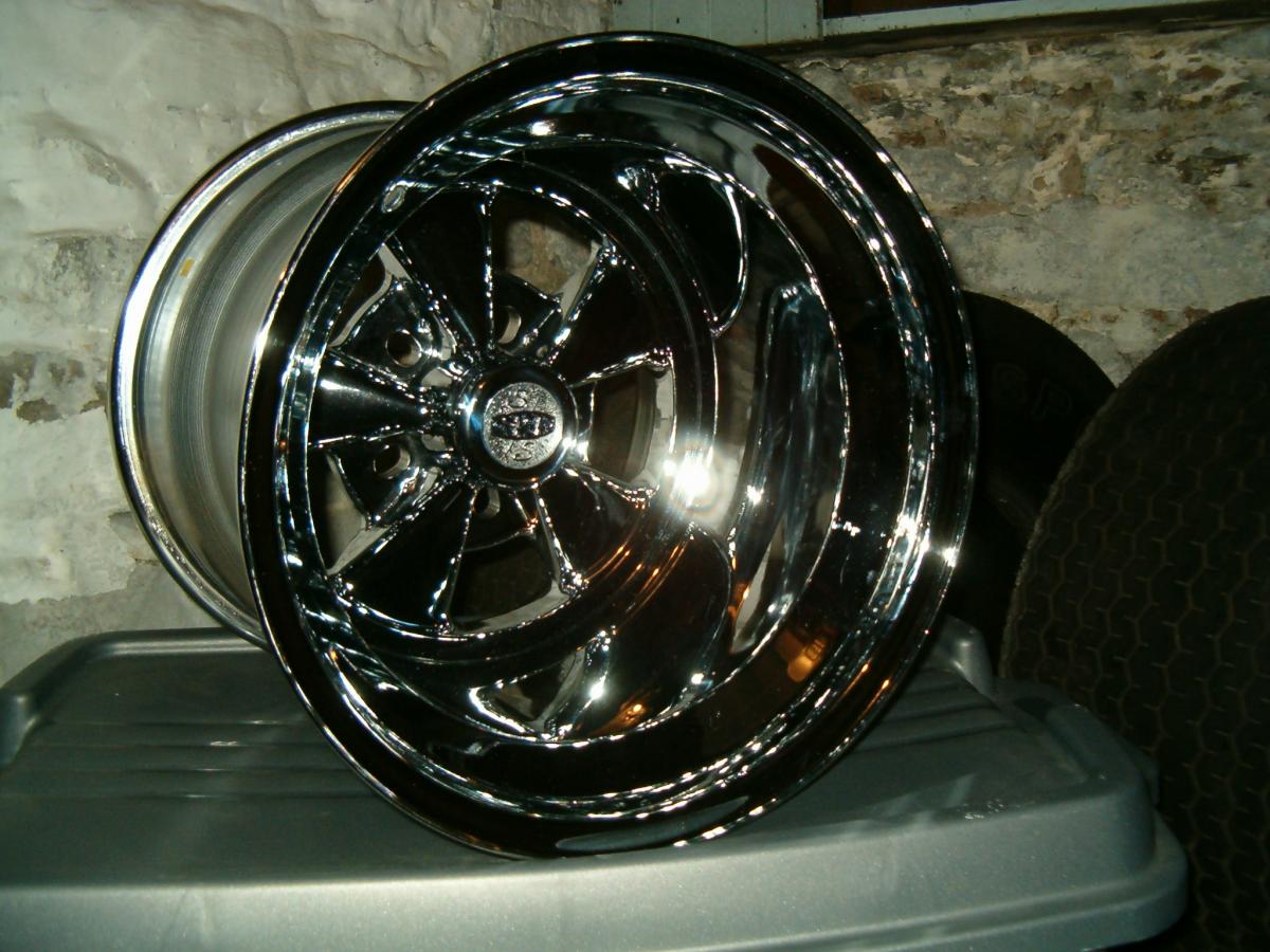

My New 15x14 Cragar S/S rims have arrived, these look Cool and they are priced well with in my budget at $200.00 each...
I've decided to use a set of the New Sportsman S/R radial in the 31x18:00-15
size.

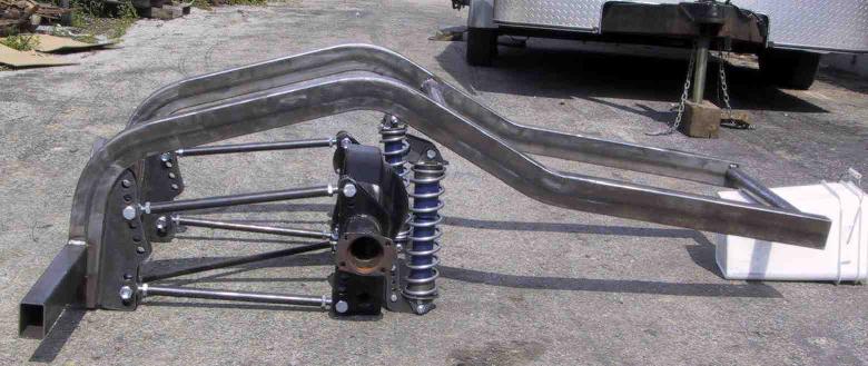

Checker Racing has the Rear Frame I've decided to use, but I'm still using a Leaf Spring suspension to cut costs......
Jegs High Performance supplied the 4 point Roll Bar kit for $250.00 shipped, this will be installed with a set of Pro Street Side bars to help tie the Charger together and improve the Chargers Torsional strength.

those are some big wheels lol. Looking good make sure you keep us updated, I think it'll look awesome when it's done. What kind of paint scheme are you thinking on doing?

Ok......... Now I'm really happy as the first of the Chassis specific components for this build have showed up....
Jeg's High Performance has a nice selection of parts for these cars, and I ordered a 4 point Roll Bar kit as a starting point, so once the Rear Frame is welded in and the rear Pass Foot wells are replaced, I'll be able to install the main hoop and Rear struts to help stiffen and reinforce the chassis so when the rear sheetmetal is all peeled off for repairs to the understucture, the whole thing will not flex or move...
The next step after the Frame clip arrives will be leveling the body on jackstands, tack welding in some structural supports, then we can prepare to go to town on the chassis...
