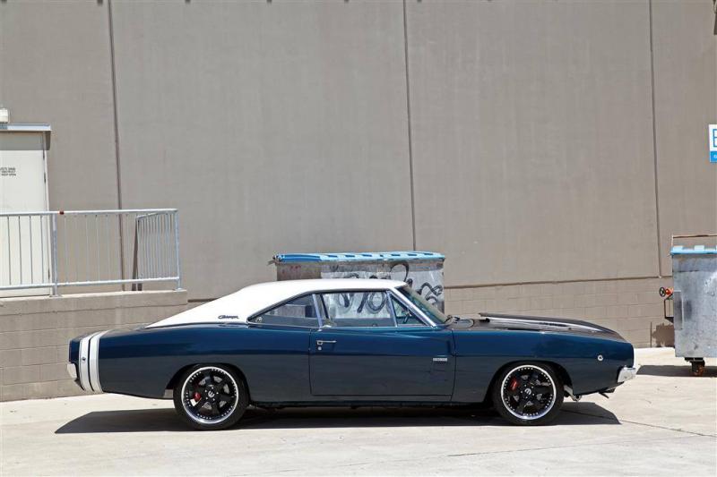

Easy enough, here's my 69 Charger with 19X10s in the rear and 18X8s in the front, zero offset on both.
You said you don't know much about wheels so I'll add that offset and backspacing are just 2 different ways of saying the same thing, 0 offset on a 10 wide wheel means 5" backspacing. 9" wide in the front will look great.

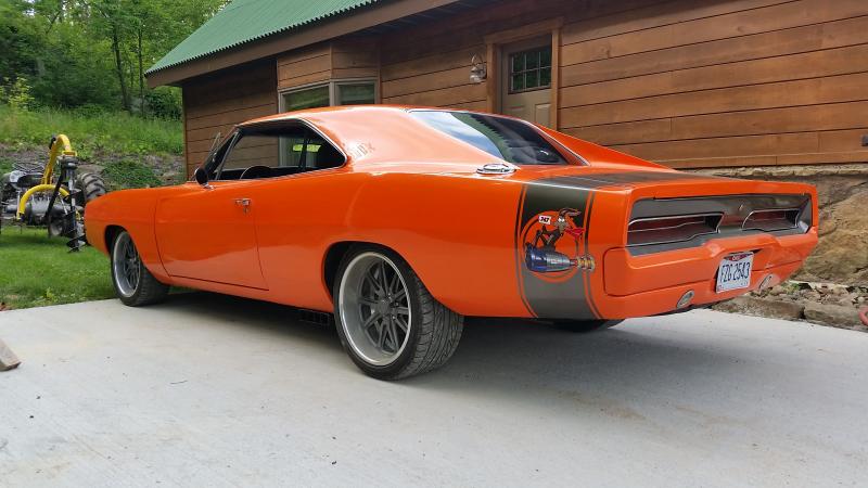

19 x 10 rear 0 offset, 18 x 8 front .5 offset

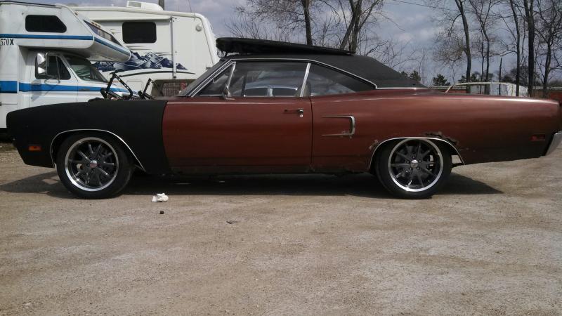

i got 18x8.5 front 4.5 bs and 18x9 rear with 5 bs
