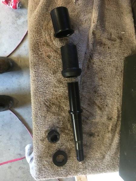

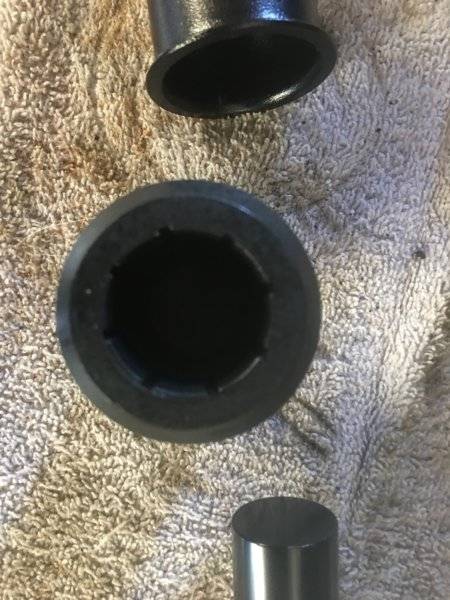

Howdy all. Anyone try this kit? It’s for my 70 Charger. I ordered it last week and it arrived today. Part number 120-10005. It includes shaft, rubber bushing and outer sleeve. Does not include inner sleeve that presses on shaft. However the rubber bushing has grooves in it for the grease to lube the shaft. I’m going to try it out.
B80A2B55-B08B-4074-BCC9-64D1EE53BE9D.jpeg B7153AC4-F087-4C18-A07F-8E7A0F1215DD.jpeg
At first I thought it was rubber but after second look it’s poly. I installed drivers side last night and it went good
