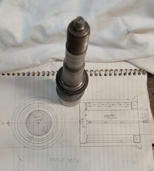

Yes, I've got the shafts with the grease fitting. The spare bushings I had came with their own grease which I have spread liberally inside and out, and yes it's very sticky. It's called Prothane Super Grease and is white.

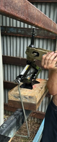

Home made press to get the bushing and shaft into the socket.

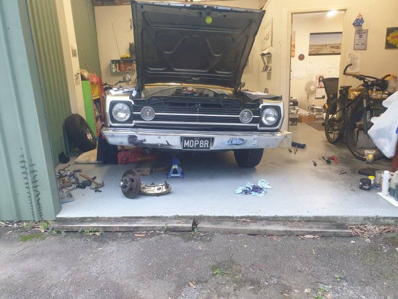

Driver's side is complete. Just need my lower back to stop hurting and I'll get into the passenger side.

I machined my own lca bushings out of chromoly steel with 3 inner rotating sleeves and drilled the shafts for a grease fitting and added a seal. I know they will be noisy but I work with urethane at my job, and I'll use urethane on end links and
sway bars and bump stops. but that's about it. And rubber is a better choice if it's not real old or not made in China. Anyway this is my experiment. I jut don't know when I will test them in my charger.
Well I finished the other side earlier this week and road tested the car a few times, then took it on a decent 100 mile run to the city yesterday
- all is well. Hopefully with the correct grease these poly bushings will last a lot longer.
It took me probably 5 hours to do the driver's side, including having to jack the engine up a touch for the LCA to clear the headers, getting all the tools out etc.
The passenger side took about 3 hours which was pretty good going. I'm not saying it's a job I want to do again, but at least I know I can get them done myself fairly quickly.
