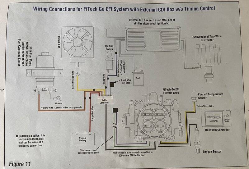

Pretty much any stand alone distributor works w Fitech. All Fitech needs from the distributor to run is the tach signal. When you get the signal from a coil, there can be noise/interference, which the dedicated tach line, similar to what MSD and HEI distributors have.I'm running my 600HP unit (30002) with a MSD type distributor and 6A orange box (no timing control), and just wondered how easy the install went for you? I see the Progression Chrysler BB unit is not HEI style but small cap dizzy, so what changed in the wiring to make that work with FiTech?
This is what mine is currently set up like. Not sure if your setup was the same, but just curious. Any info appreciated as I may consider this purchase in the future, when they are in stock again.
