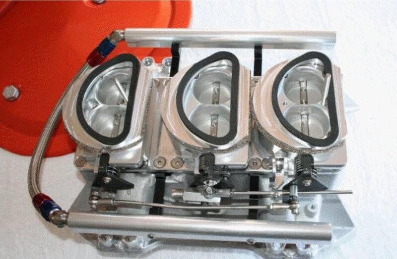

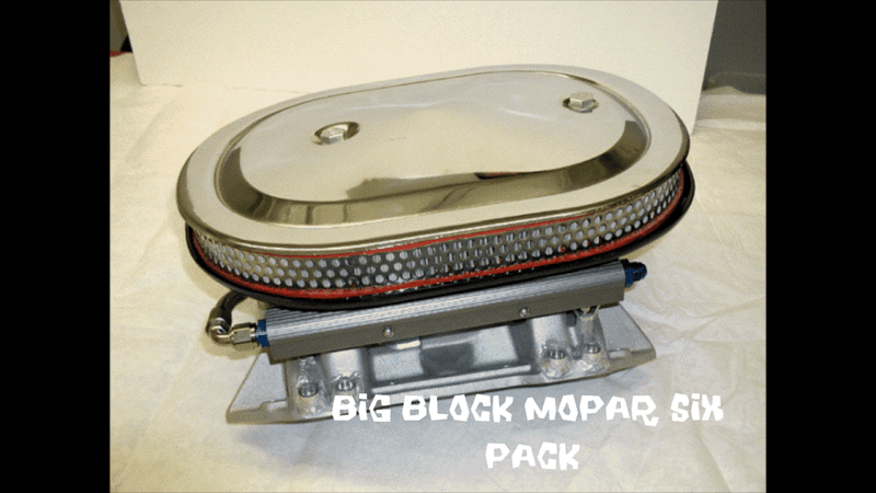

I'm always going to feed it with 3x2 of "something" starting out with my Promax modded Holleys, and the only other consideration is the F&B direct port injection setup, that uses 3x2 "air valves" (what is the correct term for them? Butterfly valves?) Like this:
I'm starting out with the Indy ModMan intake, CNCd to MW port size, with the 3 Holleys on top. Unfortunately my beautiful Weiand P3690982 6bbl intake won't allow me to use the N96 hood or setup, and I like that too much to not have it. That Air Grabber is so cool looking, and fairly functional too. I would consider an aftermarket (slightly taller than factory) A12 scoop if I ever am compelled to do that because it may allow for some significantly better intake and carbs array, or the F&B.
I may ask Wilson to look at the Weiand and see if they can open it up to MW port size, but that would definitely require a hood change, but the A12 style scoop may be tall enough.

I agree, the N96 option is too cool to lose. Hopefully you find a happy median of performance VS keeping the 6 pack.
I think you will have a beast no matter what.
