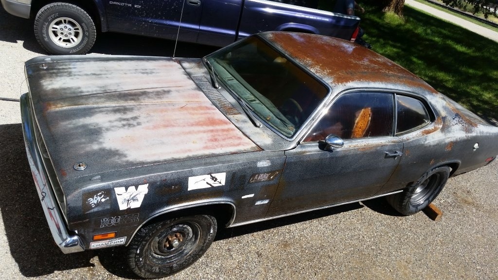

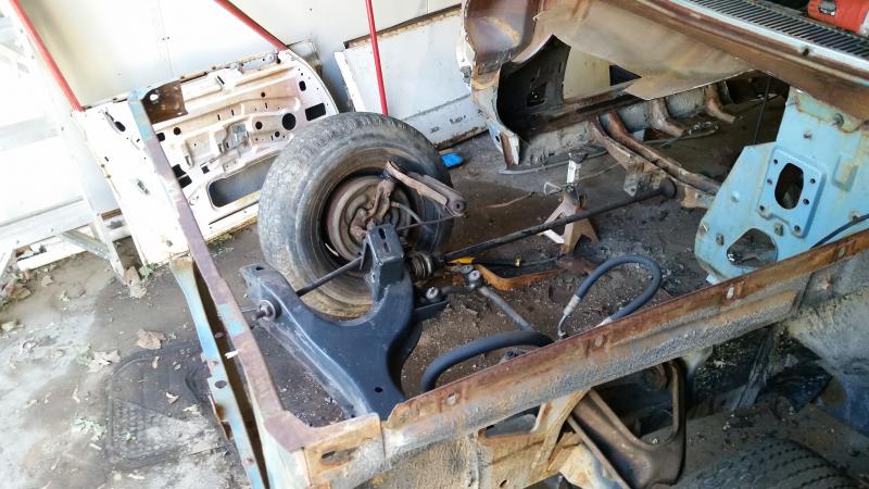

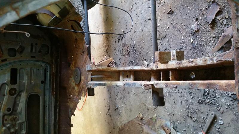

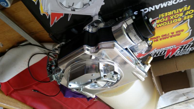

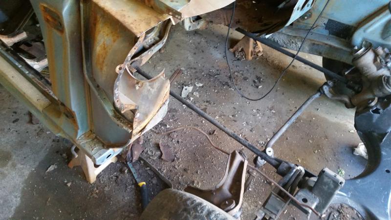

The time line is a thing of the past. It was for this weekend and as you'll see from these it is in no shape to drive. Hard to see but the cross member pictured is not straight anymore. Did get my floor patches from rock auto, like the rears, hate the fronts, they don't look good and there is no recess or anything for the gas pedal to bolt down, I think I'm gonna send the fronts back and look at some others. Also the new carbamator, 625 cfm should be more than enough. Apparently the demon is upside down and I done know how to fix it. Hmm...

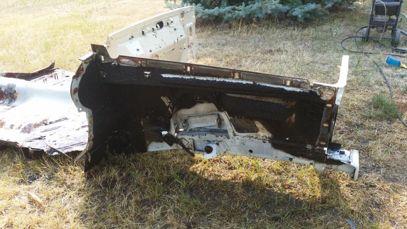

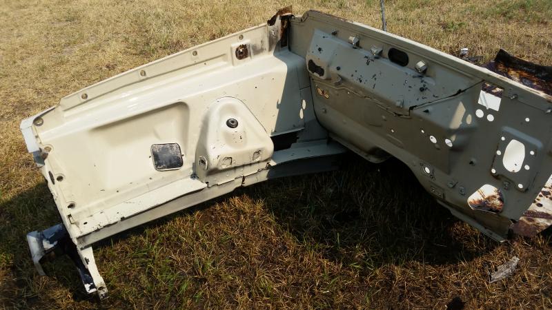

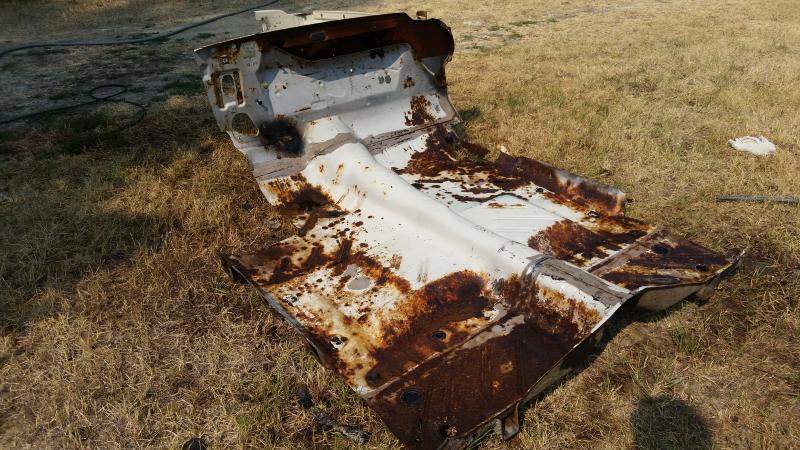

God bless parts cars, some must pass so others can survive. Got the stuff needed cut from my belvedere and spent some time with the pressure washer and super clean. Great looking donor parts to get the wagon back together.

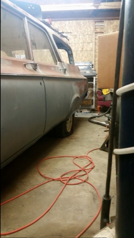

Another successful weekend in the books. All the rusted solid slant 6 running great is out of the way for the working v8 parts. Should be a roller before the end of the week and back off the lift, that'll make the parents happy. Got the motor pulled apart also. Already cleaned the heads up in the parts washer. Deffinately needs a timing set which was planned anyways and a good cleaning. The piston walls all look quite nice for however many miles are on this thing, only a slight lip at the top, should be fine for awhile. Time for parts so this thing can move on its own by mid June. Enjoy the mess of a shop with too much non car stuff in it.

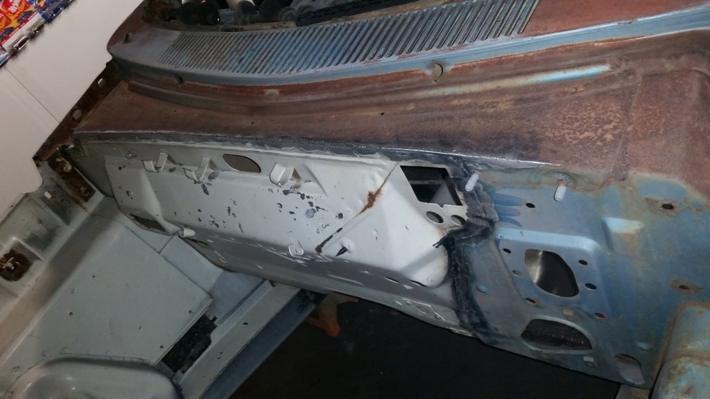

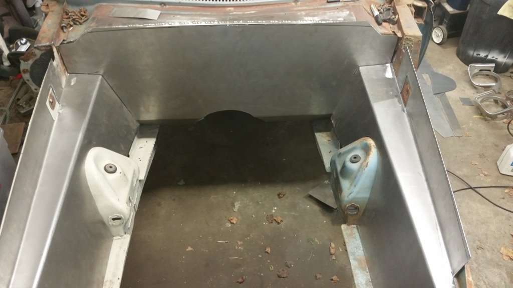

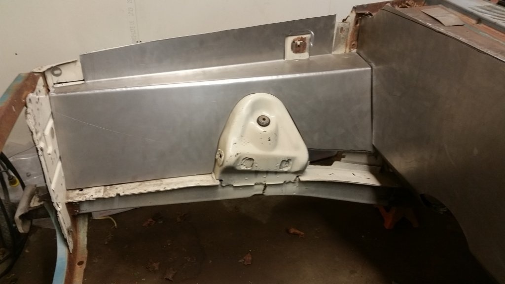

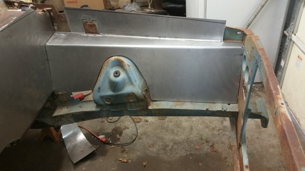

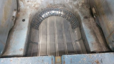

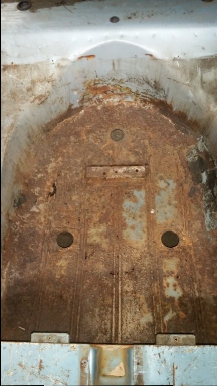

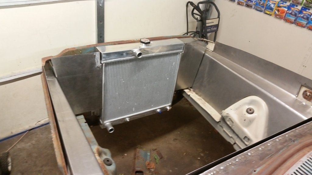

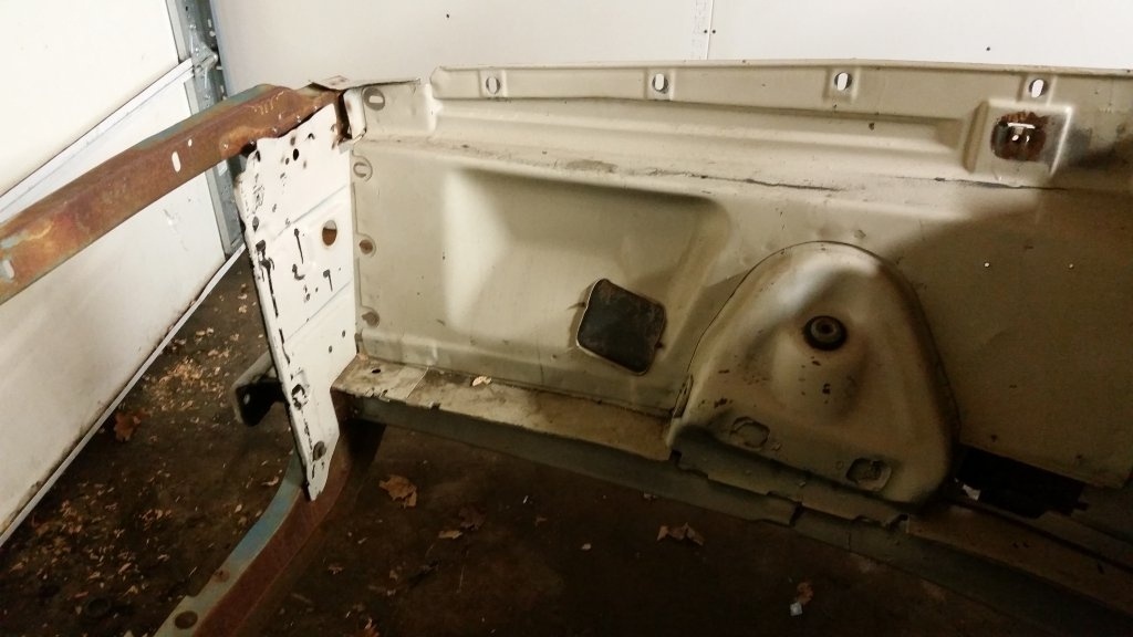

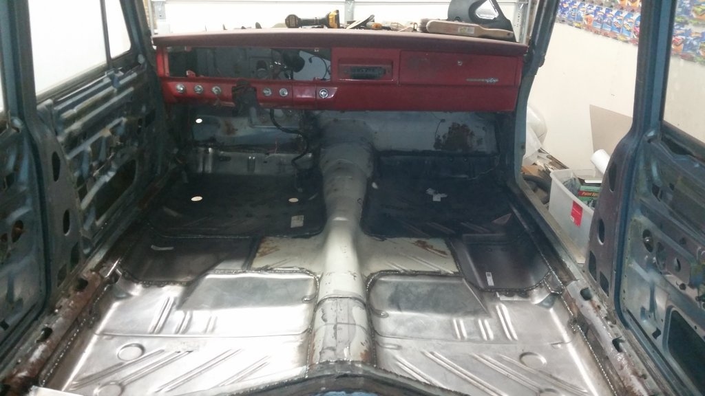

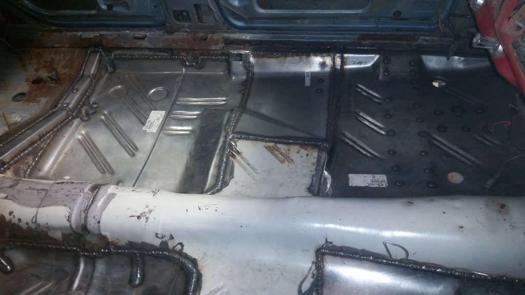

Photos of things. Donor floor, firewall, inner fender, frame rail, and cross member welded in place. Sherman Floor patch panels all welded in, great fit, great quality, great price. Made the small pieces inbetween the front and rear patches from flat 18 guage. Picked up a bead roller and had my oldest help me roll the beads in for the spare tire well area. Then decided to make more work and flatten out the engine compartment. Wiring will all be hidden. Going to use and electric assist master cylinder to lose the vacuum brake booster. The battery is being moved to the huge opening in the passenger quarter and the heater box requires some minor modification from losing the slant in the firewall. Either side of the radiator are cans, the right will be radiator overflow while the left side will be for bug fluid, the fill opening is going to be through the core support. Also building a stockish style sheet metal intake to run a 4 barrel on my poly and hide the heater hoses.
20160406_220921.jpg 20160405_212511.jpg 20160417_140214.jpg 20160417_140102.jpg 20160423_150033.jpg 20160515_150915.jpg 20160521_191207.jpg 20160521_191126.jpg 20160521_191151.jpg 20160522_200620.jpg

Cute kid. You must be young...those flares are actually 'skirts'. Be glad you're not my age...lol. Enjoying your posts. Terrific fabrication and welds. Keep it up!
