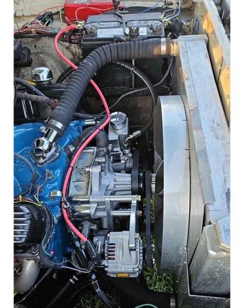

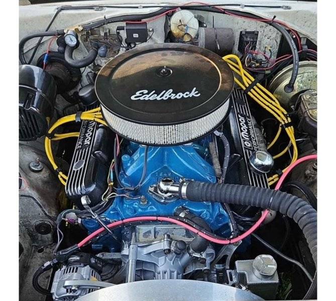

So from what I read on previous posts most small blocks run well around 12-14 initial 34-36 all in. I haven’t checked the timing yet but it’s running a little rough. Idling at 1100rpm, stalling out when put in reverse and stalling at stop lights. So there might be some carb tuning that needs to be done but would like to figure out the timing first. Since it’s not original to the car just wondering what you all thought.
I was told this engine was rebuilt with the following within the past year:
-Roller Rockers
-Aluminum intake
-Holly Electric Choke Carb
-Proform Distributor
-MSD Ignition
-Jones racing accessory drive kit (one wire alternator and steering pump)
-Carter racing fuel pump
With a 3:23 positraction rear (that I noticed kicks into second gear right around 11mph which seems to soon)
Also for what ever it’s worth I’m running it on normal gas from Costco.

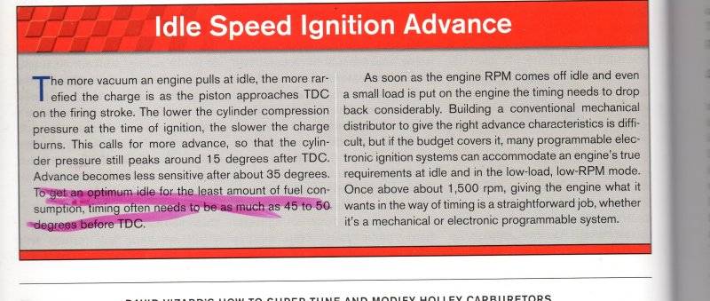

You are very smart to want to dial in the timing FIRST; most do not get 'it'.
Here is what you need to do for idle [ initial ] timing:
- vac adv disconnected & plugged
- engine idling, in gear, rpm as low as engine will tolerate
- starting at about 12-14*, turn dist slowly to advance timing. Rpm will increase & idle will get smoother [ how did I know that? ]. Keep advancing until you have highest rpm/smoothest idle.
- now check the timing. Could be as much as 40*.
- report back for next step
- see below as an example of what the correct idle timing does.

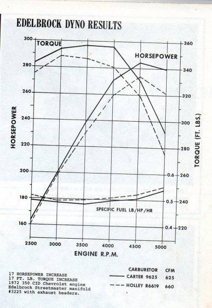

You know its funny about Carb opinions. At one time or another I've used them all. They all will work when clean and properly tuned. Some do a better job for a given use. Anybody that thinks Holley's go in the trash hasn't done a lot of heads up racing unless they were limited by carbs rules. Need to know more about the combo in question here. Carb #, Cam, compression,
