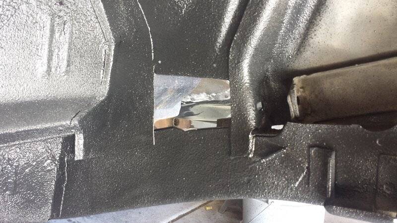

Curious as to where a guy would cut off the bedliner at the front? Really wouldn't want to see any when you open up the hood, but the bottom and outsides of the front rails along with the front wheel wells should be covered, I would think.
Anybody got any pics of how they did it?

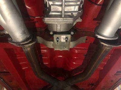

Our hero from UNCLE Tony's garage painted the engine bays of his cars WHITE for this very reason.I gotta admit, having the underside painted a lighter color (or even body color) rather than black
has GOT to help when it comes to working on things under there in the future - better visibility
of components, eh?
I know it's pretty dark under Fred when I get under there and the black just soaks up the light from
the work light.
As far as coverage. If a guy was doing both the front and rear wheel wells and not inside the trunk, would the 4 quart pack be enough, or should a guy buy the 8 pack kit?Here is a wheel well with U-Pol Raptor. The finish looks similar to a factory undercoat. The kit came with a gun. I sprayed wheel wells and spot hit the trunk extension seams.

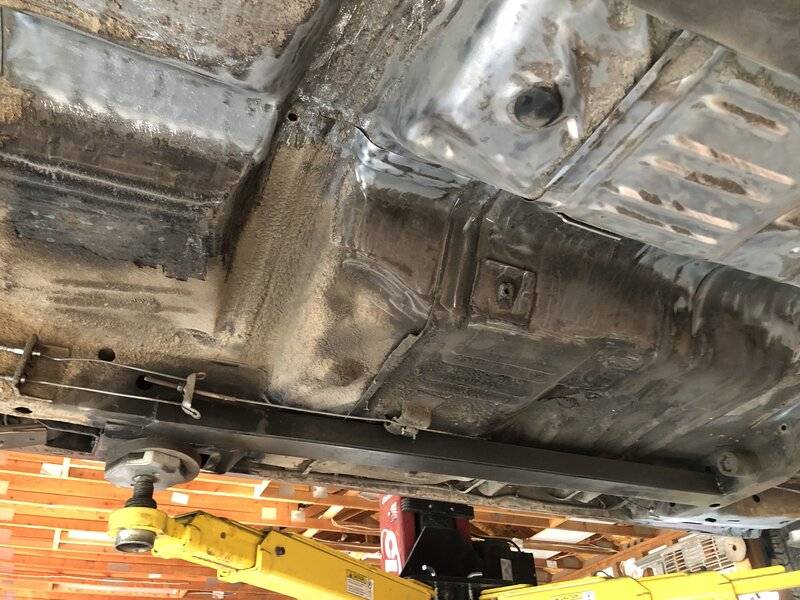

I understand your point. I also have to wonder IF a bedliner material will not have the same discolaration of the OEM type undercoat? If the underside is ride of any rust, a good epoxy primer ( several coats) and a good acrylic urethane should be very durable for a cruiser. If a car is daily, I like the protection of an undercoat myself.When I first jumped back into Mopars in 1996, I wanted to build a car that was the best of my money and ability. I looked at cars at shows and noticed that even some really nice looking cars had a sloppy appearance underneath. I wanted to do better.
The undercoat/bedliner stuff looks great when new. It looks durable and consistent. I've seen numerous Mopars in junkyards and in daily service that were fully undercoated and sadly, that beautiful black color they had when new fades to a tan color after years of rain, dust, snow or just regular crap a daily driver will deal with.
Add in some oil leaks and the color changes.

You cannot lump bedliners and undercoatings into one category, not even remotely the same thing. Undercoating is just that, a messy coating meant only to protect metal, it doesn't cure (stays soft), it shrinks, dries out and was never designed to look nice nor be painted etc. Urethane bedliner is Urethane just like paint, it seals, it's not pourus, washes easily, can be tinted or painted and provides way more protection than paint. Being up north protection is more of a priority plus I liked the fact that if I'm working under the car and scratch the surface I won't expose metal.. it's bedliner, you can't hardly hurt the stuff. I have no chips or scratches after 17,000 miles. Don't get me wrong I prefer the beautifully painted underside of a car like yours but where I live, chip and seal roads, gravel driveway, etc... It wouldn't look that way for long.When I first jumped back into Mopars in 1996, I wanted to build a car that was the best of my money and ability. I looked at cars at shows and noticed that even some really nice looking cars had a sloppy appearance underneath. I wanted to do better.
