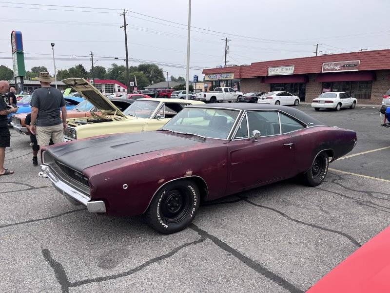

I have them in my charger and they are excellent.
I have them on my ‘68. I like ‘em, though I don’t have anything to compare.
I have them in my 65 with a 383,I had to adjust them twice,but not much. Id use them again.

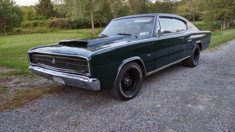

I have them on my 66 Hemi. They seem slightly stiffer than the factory bars but not by much. They ride very well with good control. Not harsh or overly stiff by any means.

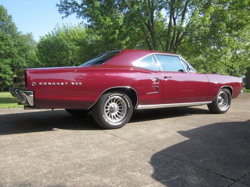

Thanks Don. During the early stages of her rebuild, I considered making her a Bee clone. So glad I kept her a 500.
