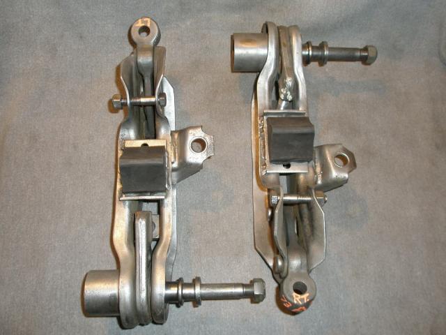

I thinking of doing the same job as you. Summit racing have the Hotchkis Sport Suspension Sway Bar End Link Mounting Brackets.
There are two or more different Brackets some har welded far out on the top of LCA and some are welded in the middle of LCA.
![w5.jpg w5.jpg](https://www.forbbodiesonly.com/moparforum/data/attachments/181/181907-fece6c3d4769e64fe6d5f08d62fe1c68.jpg)

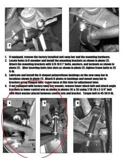

There also an option. summit racing have made a bolt on bracket to fasten on the shock mount.
http://www.summitracing.com/int/parts/sum-720230/overview/
![summit sway bar.jpg summit sway bar.jpg](https://www.forbbodiesonly.com/moparforum/data/attachments/181/181908-ba182ce6872f79f28487bd6859e0b1d5.jpg)
