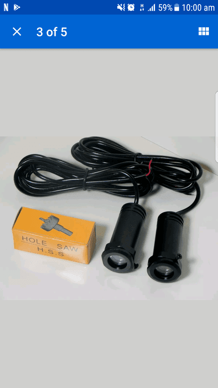

I'm guessing you will need to change the door jam switches if some of them it got single prong setup! Because using single prong setup will make both to turn on with any of the doors being opened. Needs dual prong setup door jam switches for this to make them work individually
Yeap of course, but both door jam switches are linked in just one wire net, yellow wire. If you open driver side door will turn on both doors puddle lights at the same time, like turning on the dome light.
To make them work individually need to use dual prongs switches on both doors and use one for the dome light circuit, the other one to each puddle light on each switch
