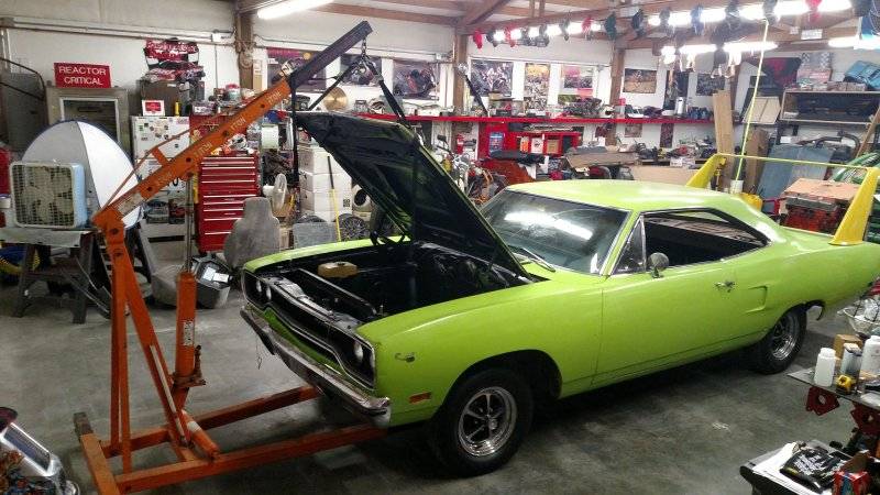

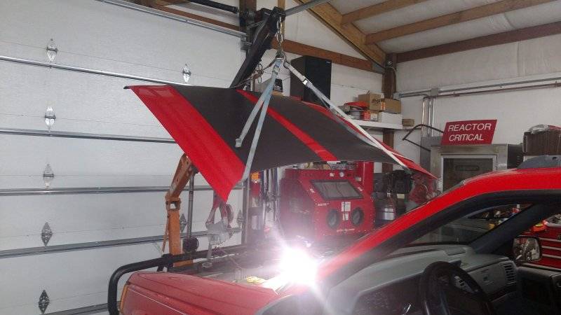

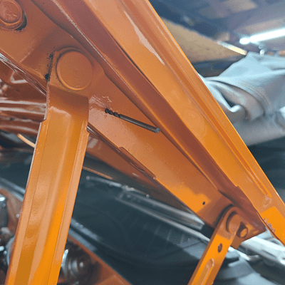

That's an old-school trick we learned a long time ago !If I have to remove a hood I like to drill 1/8" guide holes to make alignment easier.
