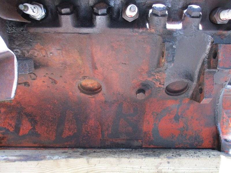

Another question: has anyone ever seen these initials (or something like them)? After cleaning the grease and grime off, I found these on the right side of the block. They appear to read "DDBC", although it could be "DDRC"
Just curious what they might mean and if they have been found on other engines. It's hard to tell whether they were put there on top of the orange paint, or before.

The lettering is the engine plants marking of what size piston rod combo to put in each cyl. A,B,C,D.

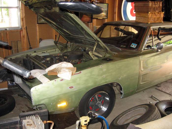

Nice Charger, where did the side markers go?
You know, I took that photo on 5 February 1969, the day I brought the car home from the dealer. And in all the many times I've looked at the picture, I never noticed that the side markers are "missing". They are there, for sure, but I have no idea why they don't show in the photo. The yellow front one could blend with the paint in the sunlight, but the rear red one should show. Strange! This one shows it a little better.
