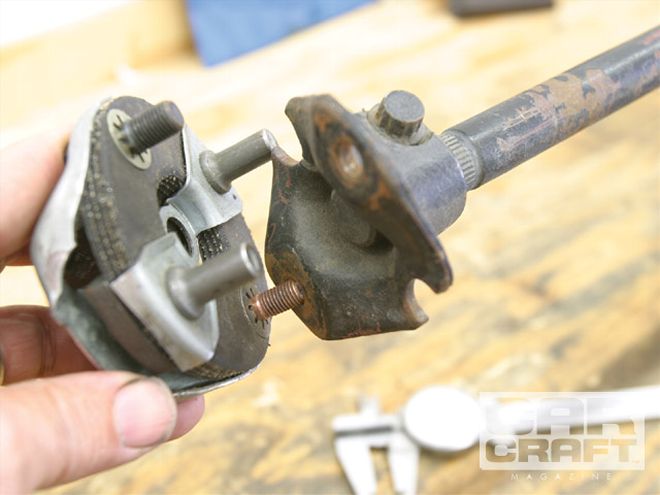

The column connects to the steering box at the coupler.
Disconnect the 2 or 3 bolts at the coupler.
I believe (cant remember) mid-way up there is a collar with a pin that gets tapped out with a Ball Peen hammer and a small punch.
Now is the time to replace the weak plastic bushing that is a FAIL item in the column
SEE PICS:

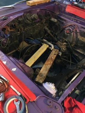

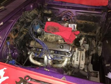

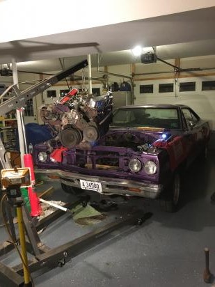

Just got cleaned up finally got the engine out. Here I didn't see the bolt tucked under the driver side where the starter was. I knew there was one somewhere just couldn't see it with everything in the way, finally had the idea to look at one of the engines on the stand to see where it was. Pretty happy I was able to do it pretty much all on my own. My dad helped when it was finally coming out so nothing got damaged (He has the experience but I wanted to do it on my own). Super_bee; Thanks I will have to take a look at that. Guessing you probably can't buy that plastic bushing locally huh? The steering linkage I was actually referring to is the bar that runs from the left to right wheel, I think its called a track rod? I'm guessing with the engine out I should be able to force it off.

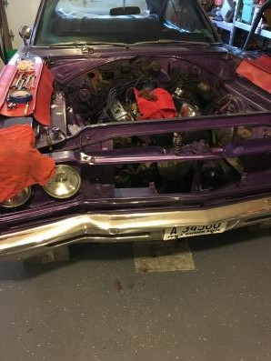

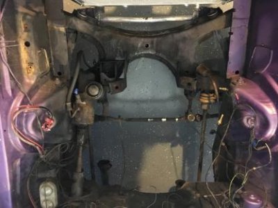

So I am sitting in the garage looking at the k frame looks pretty simple to get out but I have a question when I undo the suspension and stuff to remove the k frame is the front going to buckle or be hard to move? I'll probably wind up throwing some jacks under the firewall to hold it up anyways just wondered what to expect. If I have to move the car with the k frame out for whatever reason it's going to be a b**** isn't it?
Edit sorry I posted the pictures from my phone i don't know why they are upside down...

You seriously do not need to pull the K-frame to do this. I don't know why this has become the de-facto lore for so many guys here. It's a lot of extra work for no good reason unless you're working on the K-frame or front clip itself along with the engine.
I can't count how many motors I've pulled and they all have been from the top.
X2 on this, you can do all the detailing you need to do with it in place.
Thanks y'all I decided not to take the k frame out. I began to but having to remove a lot of extra stuff isn't what I want to do right now so I tightened everything. Glad I did I found the big 1.5"? nut on power steering box to pitman arm to hardly be finger tight... I cleaned the k frame all up and I'm just going to paint it before I paint the engine bay. In the future if I have more room and a better system I will have to try removing the k frame but honestly think it is going to be easier for me to go from the top at this time. I already have to remove the accessories to change the pully and add a power steering pump. And like my dad said If I'm adding a motor plate (undecided still) I wouldn't be able to go from the bottom anyways (hadn't thought about it).

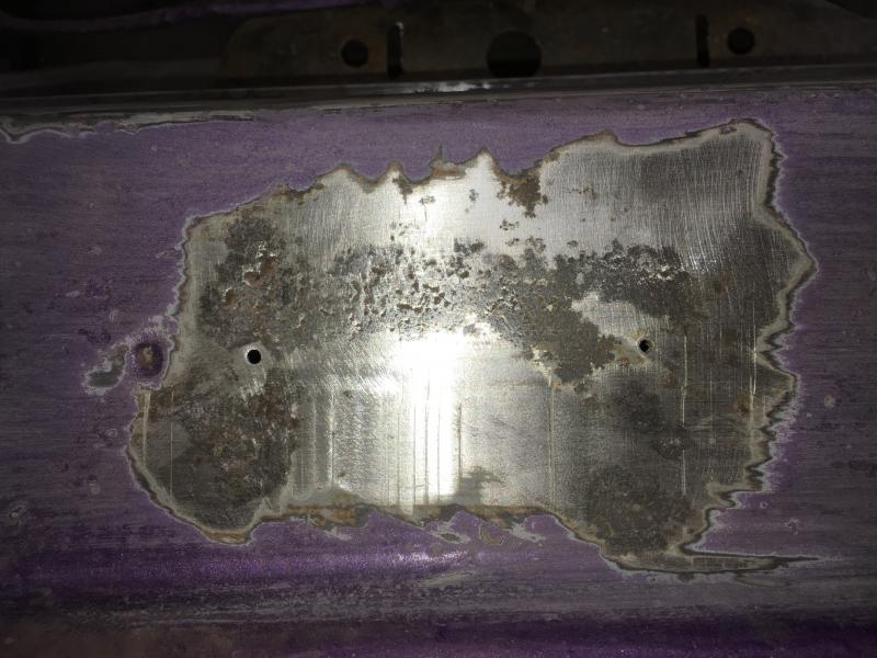

Thanks I sprayed some simple green it seemed to help a lot more than the degreaser was. I began sanding the fenders my fear was confirmed my fender tag was rusty and under neath is a lot of pitting. I know this isn't the forum to ask but any recommendations to fix this? image.jpg
