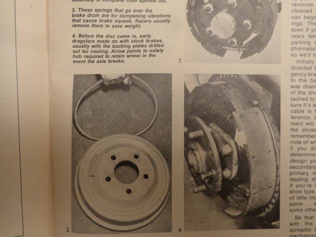

This is the best I can do in print so far.
From a 1971 suspension and brake book.
Read #3.
I stand corrected! Thanks for the information and education. Nice to learn something new everyday!
20+ horsepower to each rear wheel! Not really, I'm sure they were for noise control/chatter. Maybe throw off a little heat? My replacement drums have no springs & no problems.
