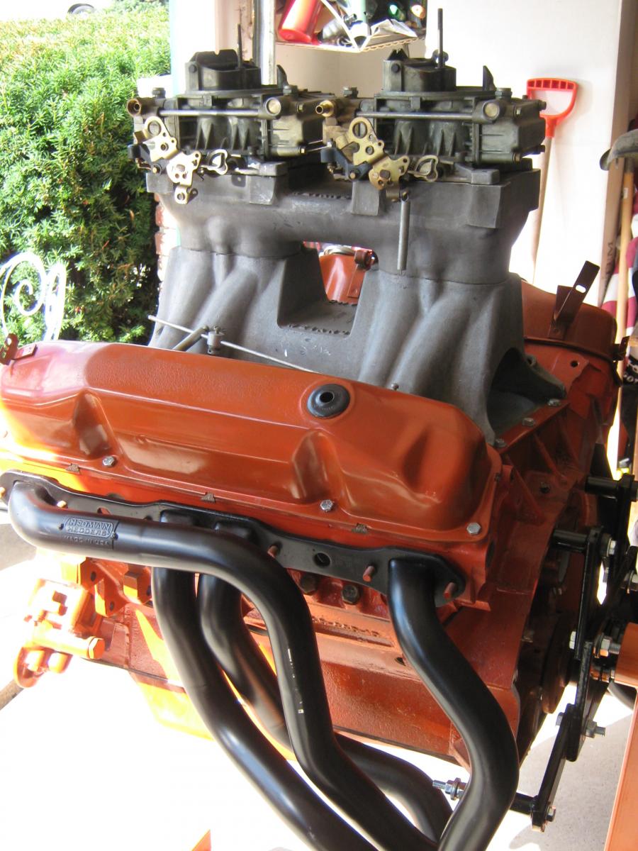

Does that car know what it's in for? :)
I had a 63 Polara with a stout 69HP motor in it. Those cars are built to handle the power
Motor is looking good

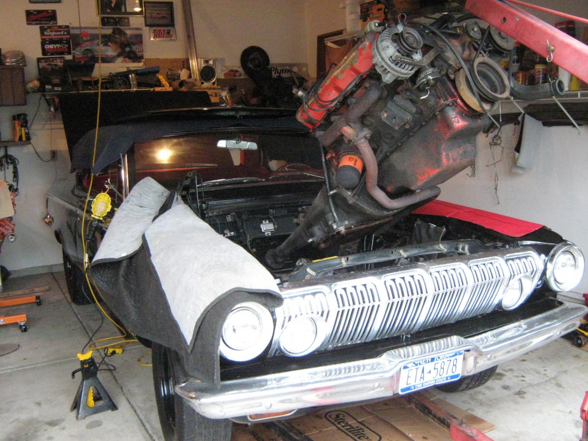

Vrroom vroom
...waiting on a few parts ..had to scrap the 318 had no offers for it ..too bad 88k ran great stripped a few things off it and hauled it away......should be buttoned up this by weekend ....... my luck it will snow next week

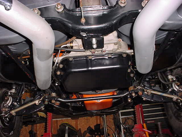

You initally said your trans was a 65.Does it have a slip yoke or flange output shaft?Here is a 65 trans in my 62.
