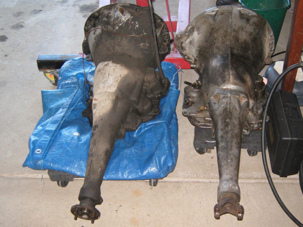

Confused is right here is pics of both trans. ...BB with yoke says 1964 inside saw it on several locations when I changed filter .. thought I could just remove yoke and replace with flange ...how does output shaft come out
They started the slip yoke trans in 65.Any numbers on the oil pan rail ?Or someone could have the tail to a slip yoke.

Let's get some situations and facts straight.
The pictured trans, one showing a 'yoke' is not normal, therefore the start of all the confusion. Just because someone starts the word that 'it' is a 65 trans, w/o the odness of it being stated leads all the discussion up a blind alley. That yoke simply needs to be removed to see what SPLINES are on the output shaft to know what you have. DOnt forget casting dates on a casting or part are only the year it was made, and clearly a mid year 64 casting date means a 65 trans. Bottom line , the yoke is weird, figure it out. Now on the the other issue, One needs the 62 to 64 MODEL valve body to fit into a 62-64 shifter car. 65's are different but can be directly swapped. 727 to 727.

THAT PIC IS NOT MY TRANSMISSION! MINE is a 65. Pulled it out myself from a 65 coronet with a big block. SAME with my rearend with 11 inch drums and driveshaft. THAT is what I AM using in my build for my 63 Plymouth. I KNOW it will ALL bolt under my car. MY QUESTION was a simple one. Is the valve body from my pb trans the same as my 65 big block. Hell I will just go look. thanks anyway.:icon_hang: This is a excellent thread, just to much confusion. Sorry I hijacked it with a question as well................

OK... today we popped off the retaining nut pulled the yoke and replaced it with the flange ..why do you feel this wont work....measured it and was the same..
