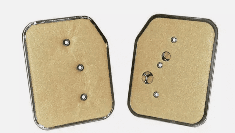

Hi Dave, correct. This is a pushbutton A727, so it's got the rear pump and I am using the filter that has the 2 intake ports on it.

This is the exact filter I'm using.
WIX # 58658
Yeah, that's the right filter. In my years of rebuilding 727's, I have had a couple of cases where new aftermarket torque converters were bad. Installing your original may pin point the problem, But BIG PITA installing and possibly removing transmission again.

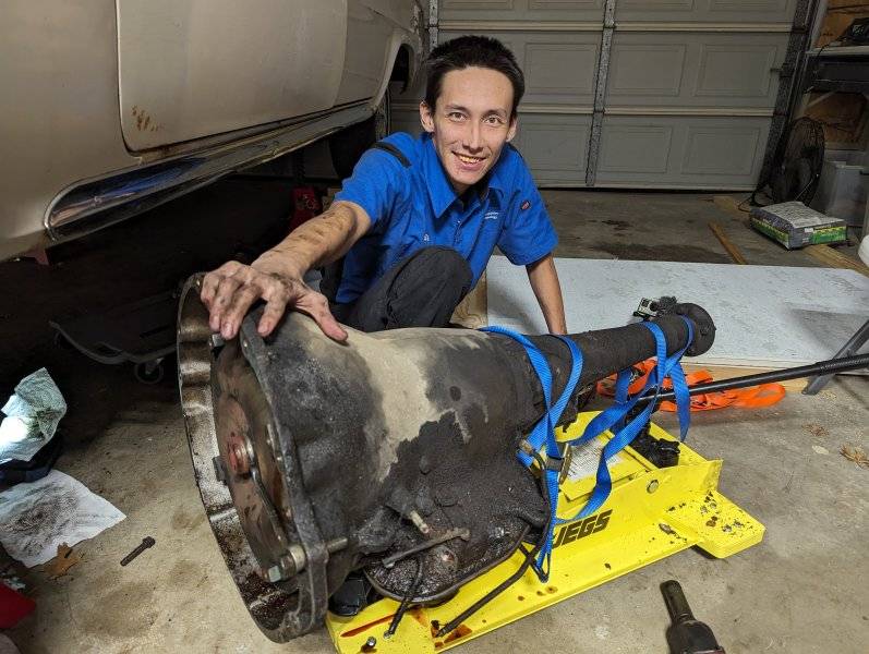

Huge respect to those that pulls transmissions right away after realizing it needs to come back out, I've been stalling in regards to my trans.
This was me roughly 6 months back, pulling the original transmission out.
Time for some deja vu again.
