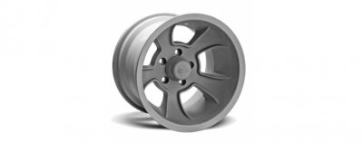

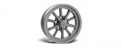

front wheels.jpgrear wheels.jpgi went on Richmond's web page today and found a ratio calculator to figure out my RPM speeds in over drive,
(6th gear) in my case a .76 gear so with, 3.55 @ 75MPH with a 26 inch tall tire (246/60-15) the RPM=2600 not to bad, now one mite think that RPM's should be lower ! but really heres where the fun begins because ther are a lot of options today in tire size & wheel combo, and i would love to stick to a mid 60's look on this 65 satellite, so now playing with there calculator again, if i use a 28 inch tall tire "2 inches taller" , my RPM's=2400 @ 75MPH that i can live with.
then i decided to see what if @ 150MPH ! WOW i don't think so ! but just haven some fun (4856 RPM)
Included pics of what I'm thinking for wheel combo ! Also a link to Richmond site;
